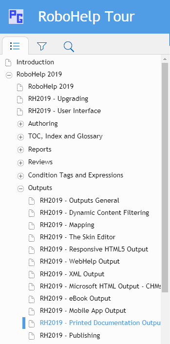

Hi all,
Got a weird one. Couldn't find anything on the forums regarding this issue.
When I drill down the TOC in my Responsive HTML5 output in Chrome, the third-level down TOC items appear blurry. Happens across several machines. Seems to be related to Chrome only, as I see no visual issues in FireFox. RH and Chrome are both up-to-date.
At browser view 100%
At browser view 125%, it looks like the blurriness gets inverted: those three topics are now clear, while surrounding topics look slightly less clear.
Has anyone seen or heard of this?
Thank you!

I couldn't replicate this problem and I can't even see it clicking on the images. Have you viewed the same output on a number of different screens?

Also I tried opening it with Chrome, same issue persists.
Jun 03, 2019 Jun 03, 2019
OK so try on a number of screens and post back. If they are all the same,
then can you share the project with me? If you can, see the Contact page on
my site the project so that I can perhaps see it. Your screenshot look OK
as well. Is that blurry for you?

It seems to be related to the transition and/or perspective properties in the layout.css which is not directly accessible in RH2019 New, but I believe is in RH2017 and RH2019 Classic.
I'm not really familiar with those css properties are though, so I'm unsure what they are for or what the implications of changing them might be. (I struggle to understand why we would need 3D effects in the table of contents?)
For example, using Peter Grainge's site in Vivaldi (chromium based browser) I can see blurriness in the third level of TOC.
If I use the developer tools to turn off -webkit-perspective: 1000 for both div.toc-holder ul li.child.show and div.toc-holder ul li.child, the blurriness goes away.
Or, I can leave perspective on but turn off -webkit-backface-visibility and backface-visibility for both those styles to get rid of blurriness.
