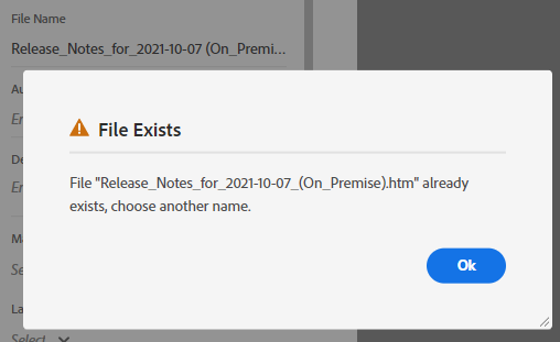

Sudanshu, I tried removing the space in the link and then re-adding it using the space bar.
When I attempted to save the change, RH displayed this message:
Note that even though a space still appears between the "7" and the "(" in the "File Name" field, which you can see in the background of that image, the system is automatically supplying an underscore in place of the blank space.
Jeff, I didn't report it last week, but I also tried your suggestion of adding multiple blank spaces.  I don't recall if I did it now using the space bar or via a different method, but the system still replaced the blanks with underscores.  Again, I have not been able to reproduce the error.  If it matters, I know that I created the topic based on a copy of another topic.  I use the same format for the release notes content, and so each new release notes topic starts as a copy (duplicate) of the previous release notes topic.  Also, the above "File Exists" message is a valid message; the file with the underscore does exist.  In fact, I attempted to duplicate the existing topic and remove a space from it, using the space bar in the "File Name" field, thinking that scenario would be close the scenario in which the error initially occurred.  If I am missing something and/or if you want me to try something else, please let me know.  Thanks.
