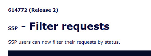

I'm using RH2022.5.28.  We're looking at implementing variables.  But when I add a variable to a heading it doesn't display using the heading style.  The heading is bold and uses a larger font size.  It displays as bold but not in the larger font size.

No. It doesn't seem to work like that.  If I insert variable text into a heading, it doesn't use the heading style.  I have to create another variable for each heading style.  As described in the link I was provided.

I don't understand, sorry.  I don't want the variable text at the end of the sentence though, it needs to be at the beginning with text after it, so the span can't be at the end.  And I didn't write the code, that was put in by RH when I inserted the variable.  I didn't add any code to the variable itself.  I'm confused.

Even if I put it at the end it still doesn't display properly.  Am I misunderstanding this?
The only way I can get it to work is if I create another variable with the styles applied in the variable itself.  So I need a different variable for each heading style it could be used in.

Unfortunately that isn't what is happening for me at all.  It does exactly what I've shown in my screenshots.

There is something else at play here as that is definitely how it should work. I have not seen anyone else report this.
If you create a new single topic project, does it work there as I have described?
Can you share your problem project? If you can, then see the Contact page on my site and send the project as instructed there. Do make sure you include a link to this thread and please do not email the project direct.

My colleague has just tried it and looked into it further, as it was happening on her projects too.  She's found what was causing it.  The css file has a style called <span>, possibly inserted when we were using Robohelp Classic years ago.  Deleting that style has made it work.
Thank you for your help.

OK. As I said, there had to be something else at play. Glad you have sorted it out.
