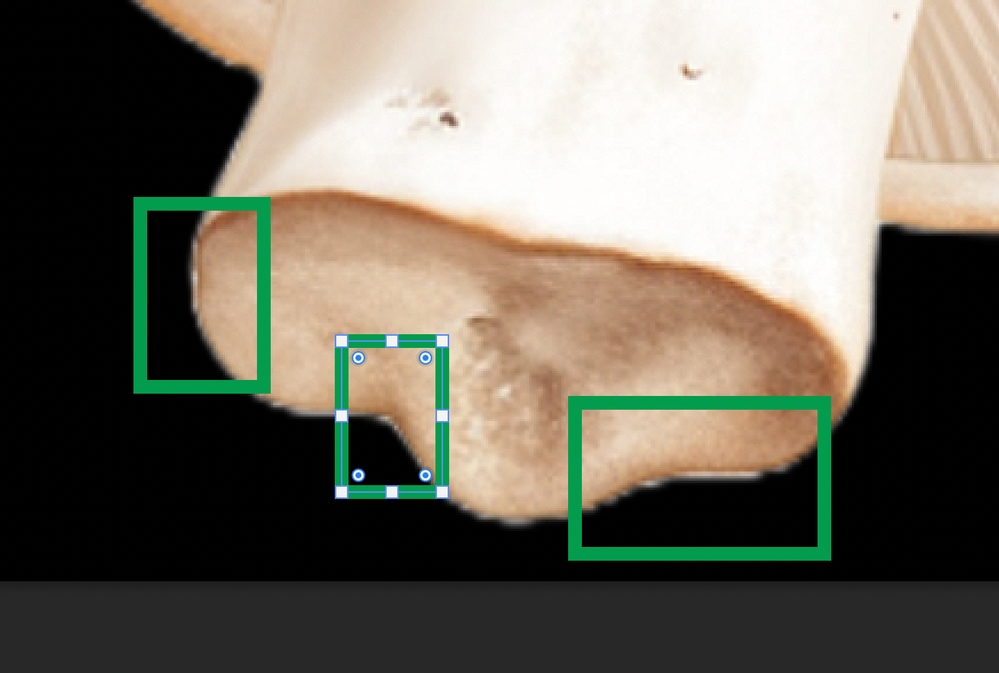

Hi everyone. I generate images with AI and remove background, I want to make the main theme of my works “products and food”. So far none of my works have passed moderation. All of them are rejected with “Quality issues”. I would be very grateful if you could help me figure out what the problem is. Here are a couple of examples of works. Thanks in advance
A few cut out issues.
IMO, your work is too synthetic & unnatural for commercial use. Read your Contributor User Guide for more tips.
The edge cutouts display many issues, and in the first image, the perspective of the various objects as compared to each other is way off.
Your food does not look very real. Look nat the tomatoes of the first asset. Besides the plastic (!) look of the food, the tomatoes really look bad.
Checking the cutout work for your assets: they are sub standard. I suppose you are using automatic cutouts. As they may be OK for some applications (and therefore have their sense), they are not OK for geneeral applications like Adobe stock.
The black line shows the limits between transparency and full matierial. You see that there are many trans
...Same issue with your first picture:

Rem_Siren - sorry, I don't know where to begin ... the salmon is way too big, the round fruits are not round, the fruits are not like real fruits, the cut outs are sloppy .... you have to pactise a lot! The colors are too bright - especially the musrooms.

Thanks for the help, I'll work on my mistakes
Copy link to clipboard
Copied
The black line shows the limits between transparency and full matierial. You see that there are many transparency errors in this asset.

In addition,One of the extras or decorative elements shows no detail or structure. It looks like a lemon, but you can't determine the fruit.

Thank you very much for your help. Yes, I use a program to automatically remove the background, but then refine by hand on the tablet. But I don't have experience in this area, so I'm working primarily on the visual component. Thanks again, I will try a different approach.
