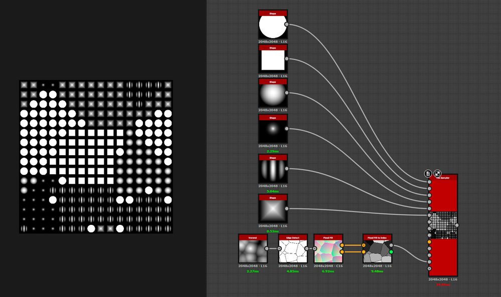

Thanks, so I assume flood fill to index works identically ?
Also could I send you a scene file as I'm unable to get this working using a tile sampler as an input ?
May 23, 2023 May 23, 2023
Flood fill to index gives a greyscale value (the index) to each cell in the flood fill map. That can be used within functions or to directly look up values or inputs as I have done in the tile sampler example below.
If you want to attach and sbs file, along with a description of what you want to achieve, I'll take a look at it.
Dave
