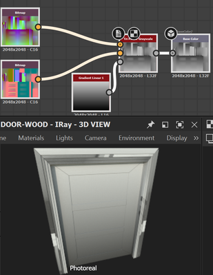

Hello
Here I have several objects together in a single object that have the same material (same substance graphic) as in the image below.
I would like to know how I can make a gradient from bottom to top aligned on all objects?
I already tried with node: 3D linear gradient and everything got messed up.
thanks

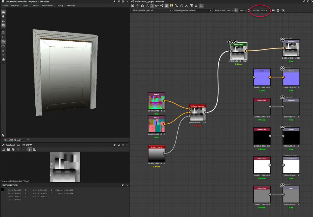

Sep 21, 2023 Sep 21, 2023
First I had to fix the model unwrap, I tried importing it to Painter, as a test, and it failed to load due to UV islands being across the UDIM tile borders. I used Blender and scaled the islands on tile 1001 to keep them off the border and re-exported the model (now called DoorWoodamended)
Now I was able to bring the model into Substance Designer and Bake the tiled Position and World Position Normal maps.
After connecting these to a Tri-Planar grayscale node (as previously described) I right clicked in the graph empty space and chose Assign Substance Graph to 3D Mesh >  DoorWoodamended >Door>All
I can now use the UV Tile at the top to display each UV tile in turn (you cannot display them together in 3D view - that is a limitation of Substance Designer).
Dave

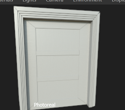

HELLO
I took the test.
There was this dirt on the channel that I'm not using:
can it be corrected?
As for this other question:
can you help me ?
How can I, on this port, one object do: ambient occlusion on the other?
thank you again
