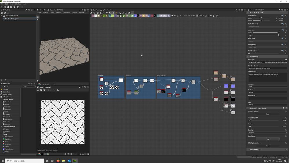

First make the herringbone using a brick generator and tile generator (as a mask) I used a ratio of 4:8 for the brick and tile:
Then distort it horizontally then vertically using Directional Warp driven by a gradient with a tile set to 8 (to match the brick pattern above)
Put together you get this.
You could then go on to add the surface details and damage to the edges with slope blur ...etc
Dave.
Dave.

Genius!!!Really appreciate your idea.
