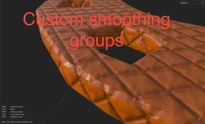

Hello everyone! I am fairly new to 3D modelling and texturing. I have repeatedly encountered an issue in Substance Painter that I cannot really find a solution online for. I often get artifacts / black lines around the UV seams. After trying various tweaks to see if they would go away, I found out that they are caused and affected by Height. For example, if I disable 'Height' on my material, they disappear. Similarly, if I set the Height Ranger slider to 0, they disappear. Height Position is also similar - If the slider is set to 0 or 1, the artifacts disappear. If it's set anywhere in between, they appear. I have attached a bunch of images with examples of the issue and how it disappears when I play around with Height settings, as well as an image of the UV's.
For the record, I use Maya LT for modelling. Can anyone help me out please? Is it something that I can fix in Substance, or is it that I am doing something wrong in Maya while UV'ing?

I've checked your mesh and the issue is related to the sharp smoothing groups the 3D model has. When you add a sharp edge with blender (blue line), it will strongly switch how the model reflects light and this can logicaly affect the normal map, which is affected by the height painting in Substance 3D painter. Therefore, I would advise you to avoid using smoothing groups for your LowPoly.

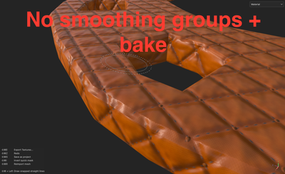

But obviously, the goal is to keep these sharp edges without the artifacts. For this purpose, keep the horseshoe with smoothing groups and use it as a high poly to bake your model.
This way, you should have hard edges and no artifacts.
With that being said, my previous answer about UV seams still applies, so make sure to hide the seams or to use a Tri-Planar projection.
