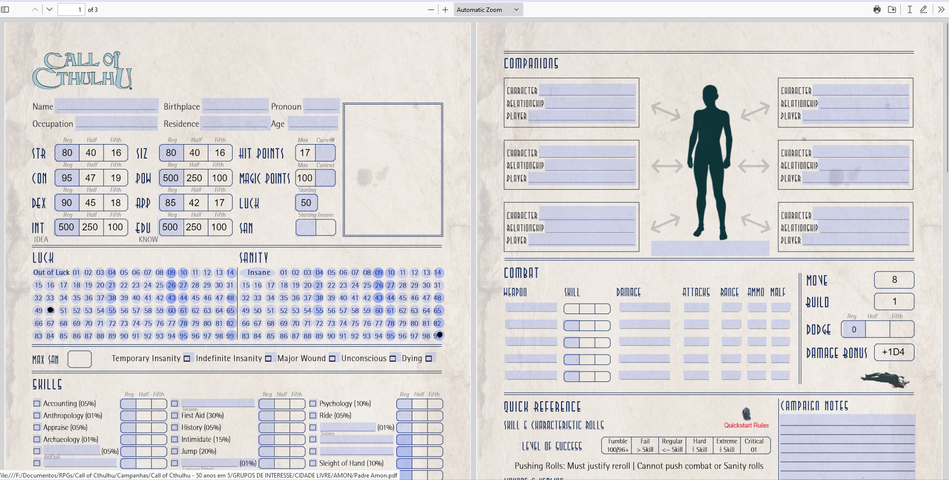

When utilizing Adobe Acrobat Pro to read PDFs, there's a blue overlay coating all pages of all documents. Opening the very same document on any other pdf reader doesn't present the blue tint. It popped up out of nowhere yesterday and it's quite infuriating. I would like to know how to remove it, if possible. Thanks.

We have checked the images, and it seems to be the form fields. In Acrobat, when you add form fields, they appear in blue.
Would you mind sharing the original PDF so we can confirm?

The pdf is attached. As you can see, it is completely blue, like if I have layered a blue hue over it. The screenshot_24 compared to screenshot_25 is completely blue. I'm not refering to the blue forms boxes. I'll attach another example

We checked the PDF you shared, and it appears fine on our end. Try repairing the application. In the application, go to Help > Repair Installation.
Ensure that the application is updated to the latest version. In Acrobat, go to Help > Check for updates.
For more information about the latest updates, refer to the following help page: https://helpx.adobe.com/acrobat/release-note/release-notes-acrobat-reader.html.
If the issue still occurs, share the PDF in screenshot 27.
Share the Acrobat and OS version numbers. We will look into this.
