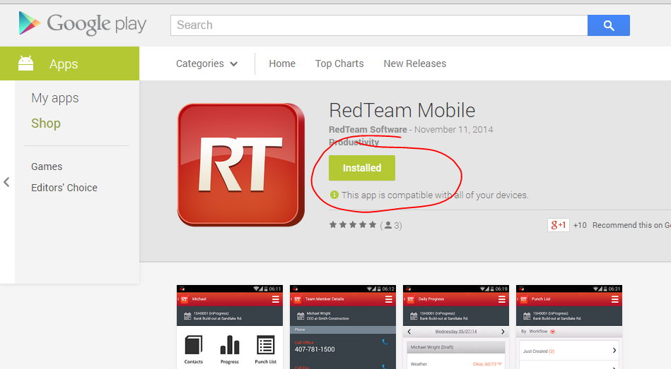

New Here ,
Nov 19, 2014 Nov 19, 2014
Hi Chris,
See below as per requested:
Device: Nexus 5
Prior OS version: Android 4.4.4
App: RedTeam Mobile
RedTeam Mobile - Android Apps on Google Play
I received yesterday the option to Upgrade to Android 5.0 on my device, at that time the App's icon listed above resided on my phone desktop.
After the upgrade, I immediately noticed the icon was missing from the desktop as well from the list of "All Apps". As you can see on the image attached the RedTeam is not listed in Settings / Apps / All (or Downloaded)PicsArt_1416398639210.jpg
When I go to the Google Play app, I see the RedTeam App is listed (with an on the right) but it says "Free", as is not installed. (you can see this also in the second image)PicsArt_1416398723183.jpg
Once I click on that option it takes me to the RedTeam App page in Google Play with the option to Install (same happens if I try to visit the Google Play web site from a computer browser), I have attached another image.download_20141119_070016.png
Finally since my only option is to Install (even though I know is already installed) it gives me an error message:
Unknown error code during application install "-505"download_20141119_070038.png
