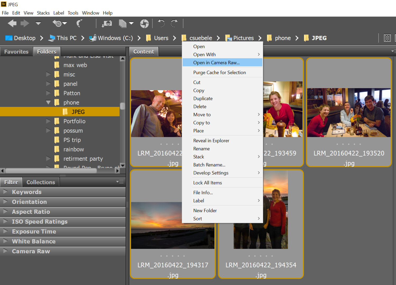

Have you tried opening the jpgs via Bridge by wither right clicking and choosing "Open in Camera Raw," or by pressing ctrl/cmd-R?

This happened to me, once, just now, when I experimented by opening a JPG with PS 2015.5 after reading this message
I set PS to Open All Supported JPGs.  Tried to open a JPG and it didn't go to CR, just straight into PS.
I restarted PS, and noticed my setting was still to Open Only With Settings, so I changed it back to All Supported JPGs and then it worked, so maybe I did something wrong with setting the preference or maybe there was something slightly corrupted with the preference that required setting it more than once or setting it and restarting PS before it would stick.
In any case I'd suggest you try setting the Always setting, again, restart PS and see if it works.
If not, then go to Bridge and use right-click Open with Camera Raw and then Open Image from CR into PS, then restart PS, and check that the preference is Open All Supported JPGs   Then try opening a JPG from PS, again.
