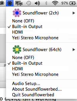

  2. Within Soundflowerbed main menu drop down (see flower icon in your menu bar), check Built-in Output for both Soundflower 2ch and 64ch:

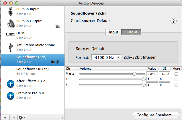

    Within Soundflowerbed main menu drop down, select Audio Setup...
    midiicon.pngTip: If you don't see a resulting display, try closing the Audio Midi Setup by rt clicking and closing the piano icon application. Then try opening Audio Setup again.
  5. Within resulting Audio Devices display:
    Make sure the Format, Volume, Value, dB settings look similar to these:
    Format: 44100.0 Hz  (2ch-32bit integer)
    Soundflower (2ch) Output: Master Vol=0.845, dB = -3.192  (no mute) | for 1 and 2: Vol = 1, dB = 0, (no mute)
    Soundflower (2ch) Input: for M, 1 and 2: Vol = 1, dB = 40.5 (no mute)
    This is shown in the following:
    Close the display, and rt click and close the Audio Midi Setup (piano icon application).

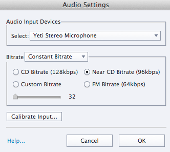

By the way, the other Audio settings in Captivate rather fall-out ("inherit") from the prior System Preferences you performed. The main other thing regarding sound is selecting your input (narration) device, which can be found in the Captivate Preferences/Recording Settings/Audio Settings:
captivate_setting.png <-- You can use built-in input or a mic (like I have). If using a mic, mute it for now.
