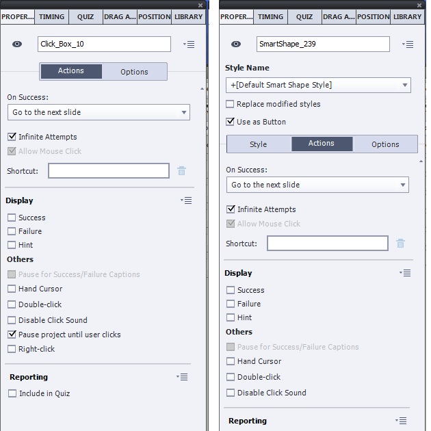

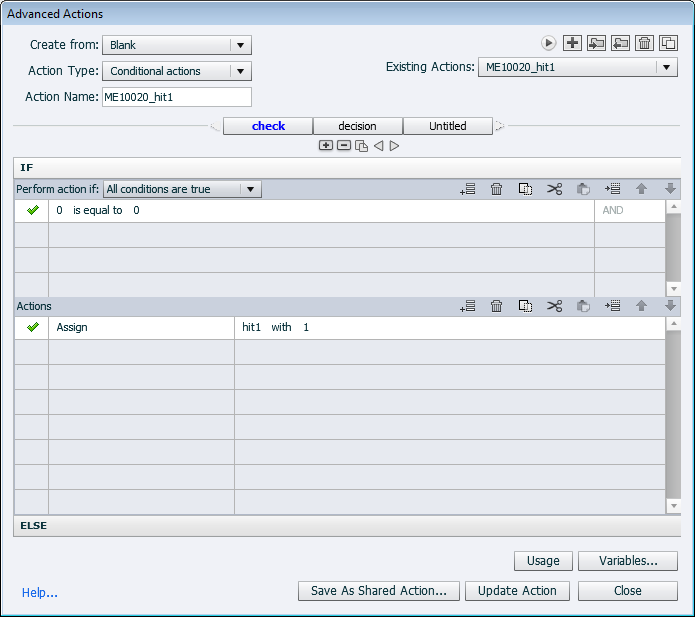

Hi, I'm also having a slide advancing problem using CP8. I have three smart shapes used as buttons on the screen. After each is clicked, a prompt to click Next (in the playbar) shows. I have a click box after the prompt to stop the screen from advancing. This works fine if I only click the items once. If I click them again, the screen advances.

Advanced actions of smart shapes....
Properties for Click Box and Smart Shape that "pause" the slide
Any help would be greatly appreciated. I need to send this out ASAP.

I think the real issue is that neither the smart shape button NOR the click box are making the movie pause even though the click box is set to pause until the user clicks it.

It is very difficult to understand when you don't label any object. What is the 'prompt', please? What I see at this moment:
  • user can click as many times to show the popups on the shape buttons (?) hsx... until
  • all have been clicked at least once, then the playhead is released.
  • playhead will stop again at the pausing point of the click box until?????
  • then the playhead will stop again at the pausing point of the 'smart shape' button.
If this doesn't happen, it means that the click box and/or the 'smart shape' button are invisible in their properties.
BTW group the popups, you can then hide the group and show one of them. Saves at least one statement is also more efficient for shared actions and in case you have more popups.
