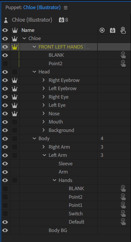

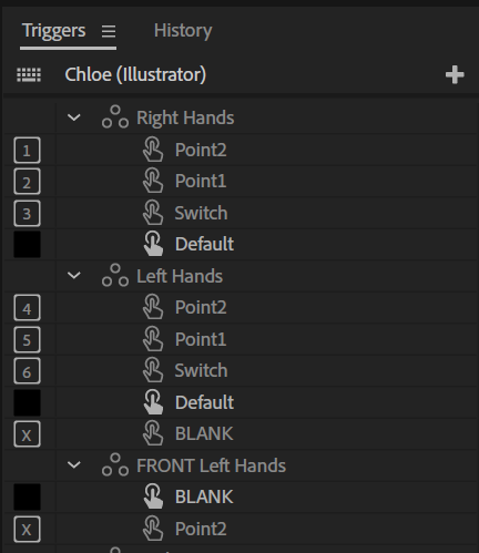

LEGEND ,
May 16, 2018 May 16, 2018
In case useful, is this sort of what you are trying to achieve? (Sorry, I have not read everything in this thread. Sneaking in quickly at end of lunch break.)
I created a new group in front of head and put new hands there, including a blank hand (has a single point in it, so nothing will render). I make that BLANK hand the default for a new swapset. See "FRONT RIGHT HANDS"
I also added a new BLANK to the "Left Arm" / "Hands" group above.
I then set BLANK for the FRONT group to be the default, and assigned "X" as a keyboard trigger to both BLANK in LEFT HANDS and Point2 in FRONT LEFT HANDS. So when I press "X", it similtaneously changes two independent swap sets - it makes the current hand in the old swap set flip to "BLANK" (so it visually disappears), and makes a FRONT hand visible.
Further, I had to then attach the front hands to the arm so they moved with the arm. To cheat, I removed independence from the arms so it was then easy to attach the front hands to the arms. If you need independent arms, that requires more work (similar to the "rear hair group" discussions).
End result, pressing X makes a pink hand appear in front of the face. This the timeline and GIF of me pressing and releasing "X". Two swap sets are recorded from the one key stroke.
The pink hand is the one in front - notice it go in front of the head, even though attached to the arm which is behind the head.
Oh, and sorry I sometimes said FRONT LEFT HANDS and FRONT RIGHT HANDS - typing mistake - its the one group. No time to fix just now.
