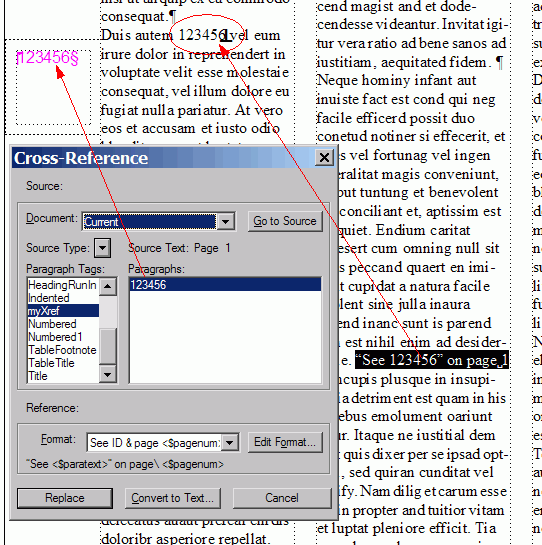

There is a technique to make the type of cross-reference that you want, i.e. a link to a unique string instead of the entire paragraph of text.
You need to go about it in a round about manner using FM's Views with an invisible colour.
1. Create a custom colour, e.g. Xref_color, for the text that you want to make a cross-ref to. Note: it can be any colour that you want as it will never be output.
2. Now go to your Color Views; View > Color > Views... and set View 6 to have this new colour moved to the Invisible column.
3. Create a new paratag, e.g. myXref, for text to be entered using the new colour.
3. Now at the location that you want to make the cross-ref to (e.g. an Id number referenced in a paragraph), drop in an anchored frame using either outside column or outside text frame (as these locations do not repel text) and then insert a text frame within that anchored frame. Using the new paratag, enter the ID number inside the Aframe text box.
4. From the location that you want the xref, insert your xref format and use the myXref paratag as the target.
5. If you want the cross-ref link to take you to exactly the location of the ID in the text, then move the anchored frame over top of the text in the paragraph, ie.
5. When you want to output your results change the View back to #1 (either through the View panel or use the shortcut esc v 1 to toggle) and the paragraph content for the myXref tag will disappear from view. However, FM still knows it's there and can access the content. When you create a PDF, the link will behave as if you directly linked to the content inside of the paragraph.
To make inserting the Aframe properly set-up easier, create one with the text frame and paratag on the Reference page so that you can copy and paste as required.
You can use this technique to mimic the <$marker1> <$marker2> behaviour in running h/f 's if you run out of markers as well.
Note: You can toggle colour views at the Book level for all documents at once. Using the keyboard shortcuts, it's a snap.
I hope this technique helps.
