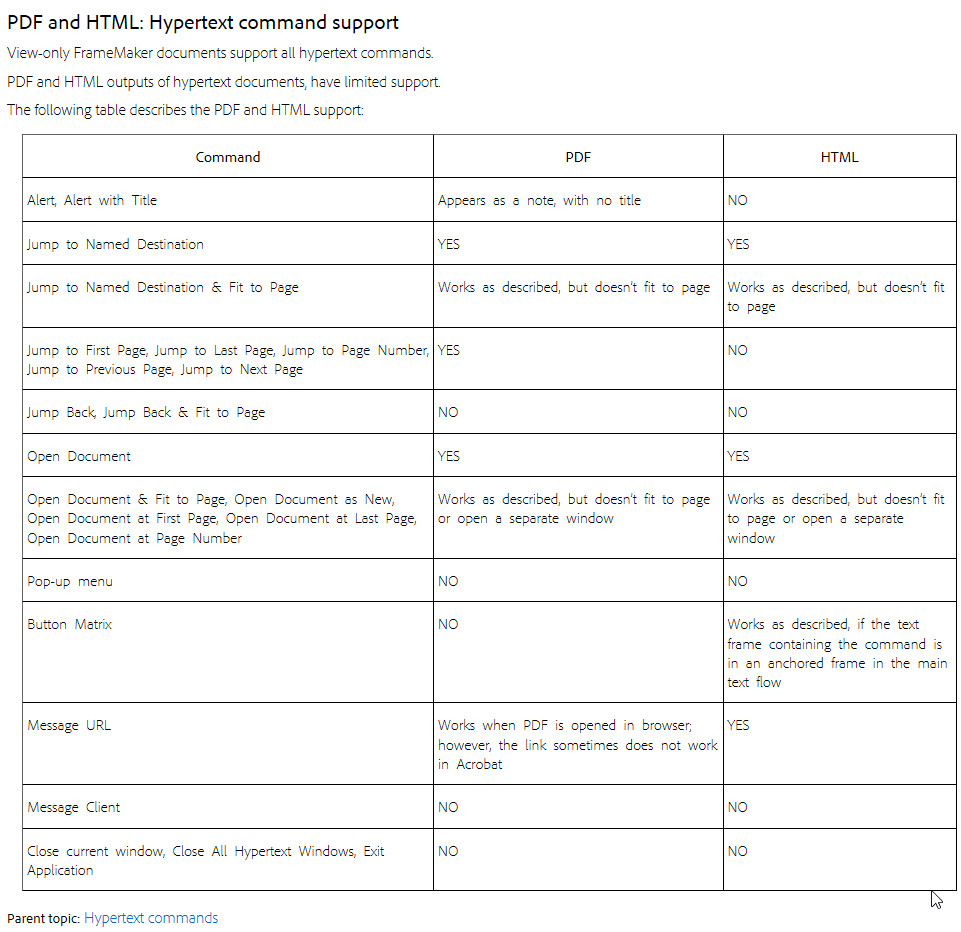

OK, I had thought I remembered that there were issues with support for linking, and I found the reference in the FrameMaker help. A bit of searching turned up this table. If I'm reading it correctly, what you want to do can't be done with bog standard Frame. I think it's possible to do using postscript commands, and Shlomo's Timesavers is the easiest way to get it done. You'll have to weigh the cost of buying his add-on versus learning how to create the postscript commands (which I think have to be put on reference pages? Again, not something I've paid a lot of attention to).

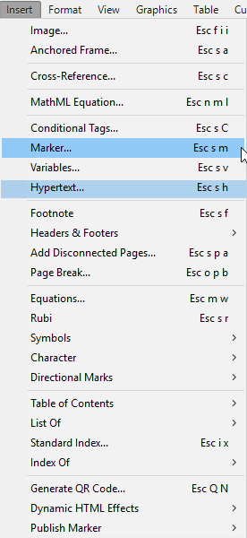

I looked over the tables and the manual containing them and while there may indeed be some issues with this feature, I confess that I'm still not clear on the proper steps to accomplish it. I'm trying the openlink <path to file> and while I did not receive an error when I clicked Update, I'm not sure what to do next. There is no Insert Hypertext Marker button in FM 19 and for some reason, I'm now only seeing a "Conditional Tags"  tab in the Hypertext dialog box (see image). I'm pretty sure that there was a Marker tab, for inserting a marker.

There is both an Insert > Marker and an Insert > Hypertext command available from the menu bar. Hypertext is a specific type of marker, and if you use that command it gives you options from a drop-down to prepopulate commands. Marker also lets you insert hypertext markers, but you have to type all the commands in by hand. The table I pasted above tells you how both the PDF and the HTML outputs react to those marker/hypertext commands; you'll note that the Frame to PDF conversion means that quite a few of the commands don't work or don't work properly in the PDF output. The notation that all the commands work in view-only Frame implies that a lot of them don't work in an editable Frame file, also, which is what I've been finding when trying to test this out.
I can understand why this used to be the case. When FrameMaker was an independent company, it also had a product called FrameViewer which allowed users to view (but not edit) Frame files and I suspect that most of these commands were developed with that model in mind. What I don't understand is why Adobe hasn't updated the code so that these commands work in PDF files (and in editable Frame files, since FrameViewer is no longer available so it's pointless to support something that only works in view-only Frame files and can't be checked otherwise). PDF is its bread-and-butter, after all.
