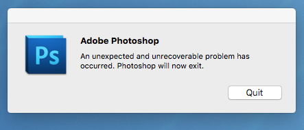

Well, unfortunately I followed the 3-step process Jacob Bugge suggested yesterday, and the issue is still occurring. I've also learned that there is an issue that causes the program to crash simply when Quitting as well. Seems like I'm going to have to just downgrade back to previous OSX so I can use my programs properly.
After reinstallation of programs, I received the following error messages when attempting to install updates:
Adobe Bridge CS5 4.0.5 Update
  There was an error downloading this update. Please quit and try again later.
  Adobe Device Central CS5.0.1
  Adobe Extension Manager CS5 5.0 Update
  Adobe Illustrator CS5 15.0.2 Update
  Adobe Player for Embedding 3.1
  Adobe XMP Panels CS5
  Adobe® InDesign® CS5 7.0.4 update
  CS Live Services Update for CS5
  Extend Script Toolkit 3.5.1 Update
  Photoshop 12.0.4 update for Photoshop CS5
  Photoshop Camera Raw 6.7 Update

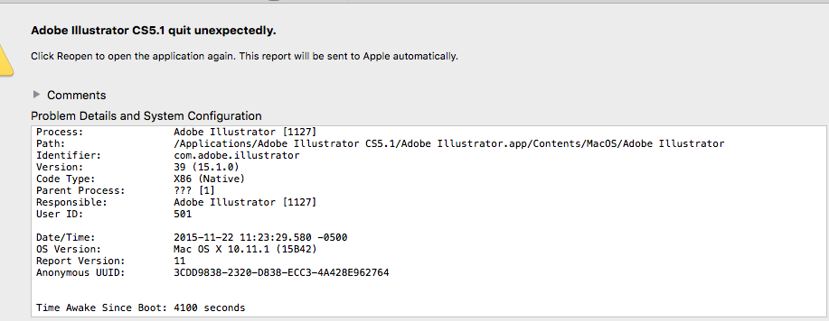

CRASH REPORTS
Also, not sure if this is of any help, but these are the crash report details from the Eyedropper crash issue, and the Program Quit crash issue..
Eyedropper Crash:
Process:               Adobe Illustrator [401]
Path:                  /Applications/Adobe Illustrator CS5/Adobe Illustrator.app/Contents/MacOS/Adobe Illustrator
Identifier:            com.adobe.illustrator
Version:               399 (15.0.0)
Code Type:             X86 (Native)
Parent Process:        ??? [1]
Responsible:           Adobe Illustrator [401]
User ID:               501
Date/Time:             2015-10-03 14:45:53.877 -0400
OS Version:            Mac OS X 10.11 (15A284)
Report Version:        11
Anonymous UUID:        63779E8B-10F6-18E5-4E6E-D72F688F9D41
Time Awake Since Boot: 320 seconds
System Integrity Protection: enabled
Crashed Thread:        0  Dispatch queue: com.apple.main-thread
Exception Type:        EXC_BAD_ACCESS (SIGSEGV)
Exception Codes:       KERN_INVALID_ADDRESS at 0x0000000000000000
Exception Note:        EXC_CORPSE_NOTIFY
VM Regions Near 0:
    __TEXT                 0000000000001000-0000000000ff8000 [ 16.0M] r-x/rwx SM=COW  /Applications/Adobe Illustrator CS5/Adobe Illustrator.app/Contents/MacOS/Adobe Illustrator
Thread 0 Crashed:: Dispatch queue: com.apple.main-thread
0   com.adobe.illustrator.plugins.EyeBucketTool 0x2d9c2693 PluginMain + 45277
1   com.adobe.illustrator.plugins.EyeBucketTool 0x2d9bcde1 PluginMain + 22571
2   com.adobe.illustrator.plugins.EyeBucketTool 0x2d9bf24d PluginMain + 31895
3   com.adobe.illustrator.plugins.EyeBucketTool 0x2d9bf8c5 PluginMain + 33551
4   com.adobe.illustrator.plugins.EyeBucketTool 0x2d9b8349 PluginMain + 3475
5   com.adobe.illustrator.plugins.EyeBucketTool 0x2d9b7763 PluginMain + 429
6   com.adobe.illustrator         0x006c282e AWS_CUI_RevertAlert(OpaqueWindowPtr*, adobe::aws::gen::String<unsigned short>&, adobe::aws::gen::String<unsigned short>&) + 3698310
7   com.adobe.illustrator         0x006be993 AWS_CUI_RevertAlert(OpaqueWindowPtr*, adobe::aws::gen::String<unsigned short>&, adobe::aws::gen::String<unsigned short>&) + 3682283
8   com.adobe.illustrator         0x006c6656 AWS_CUI_RevertAlert(OpaqueWindowPtr*, adobe::aws::gen::String<unsigned short>&, adobe::aws::gen::String<unsigned short>&) + 3714222
9   com.adobe.illustrator         0x001ab95d AWS_CUI_GetVersionComments(OpaqueWindowPtr*, adobe::q::QDocument&, adobe::q::QString&, adobe::q::QAttributeList&, adobe::q::QDocument*, adobe::q::QProject*, long) + 1634569
10  com.adobe.illustrator         0x005618c3 AWS_CUI_RevertAlert(OpaqueWindowPtr*, adobe::aws::gen::String<unsigned short>&, adobe::aws::gen::String<unsigned short>&) + 2252571
11  com.adobe.illustrator         0x0011180b AWS_CUI_GetVersionComments(OpaqueWindowPtr*, adobe::q::QDocument&, adobe::q::QString&, adobe::q::QAttributeList&, adobe::q::QDocument*, adobe::q::QProject*, long) + 1003447
12  com.adobe.illustrator         0x00177047 AWS_CUI_GetVersionComments(OpaqueWindowPtr*, adobe::q::QDocument&, adobe::q::QString&, adobe::q::QAttributeList&, adobe::q::QDocument*, adobe::q::QProject*, long) + 1419251
13  com.adobe.illustrator         0x0014af56 AWS_CUI_GetVersionComments(OpaqueWindowPtr*, adobe::q::QDocument&, adobe::q::QString&, adobe::q::QAttributeList&, adobe::q::QDocument*, adobe::q::QProject*, long) + 1238786
14  com.adobe.illustrator         0x00154992 AWS_CUI_GetVersionComments(OpaqueWindowPtr*, adobe::q::QDocument&, adobe::q::QString&, adobe::q::QAttributeList&, adobe::q::QDocument*, adobe::q::QProject*, long) + 1278270
15  com.adobe.illustrator         0x005a6221 AWS_CUI_RevertAlert(OpaqueWindowPtr*, adobe::aws::gen::String<unsigned short>&, adobe::aws::gen::String<unsigned short>&) + 2533497
16  com.adobe.coretech.adm        0x0c50b83d 0xc500000 + 47165
17  com.adobe.coretech.adm        0x0c53aa0c 0xc500000 + 240140
18  com.adobe.coretech.adm        0x0c55e1e9 0xc500000 + 385513
19  com.adobe.coretech.adm        0x0c585229 0xc500000 + 545321
20  com.adobe.coretech.adm        0x0c5858e3 0xc500000 + 547043
21  com.adobe.coretech.adm        0x0c56d065 0xc500000 + 446565
22  com.adobe.coretech.adm        0x0c561a9d 0xc500000 + 400029
23  com.adobe.illustrator         0x005d8462 AWS_CUI_RevertAlert(OpaqueWindowPtr*, adobe::aws::gen::String<unsigned short>&, adobe::aws::gen::String<unsigned short>&) + 2738874
24  com.apple.HIToolbox           0x9b3b168b _InvokeEventHandlerUPP(OpaqueEventHandlerCallRef*, OpaqueEventRef*, void*, long (*)(OpaqueEventHandlerCallRef*, OpaqueEventRef*, void*)) + 36
25  com.apple.HIToolbox           0x9b3599a0 DispatchEventToHandlers(EventTargetRec*, OpaqueEventRef*, HandlerCallRec*) + 1832
26  com.apple.HIToolbox           0x9b358bb4 SendEventToEventTargetInternal(OpaqueEventRef*, OpaqueEventTargetRef*, HandlerCallRec*) + 402
27  com.apple.HIToolbox           0x9b36bf6d SendEventToEventTarget + 34
28  com.apple.HIToolbox           0x9b514c2c SendEventFromMouseDown(OpaqueWindowPtr*, unsigned long, OpaqueEventRef*) + 167
29  com.apple.HIToolbox           0x9b514825 HandleWindowClick(OpaqueWindowPtr*, Point, short, unsigned long, OpaqueEventRef*) + 539
30  com.apple.HIToolbox           0x9b514a21 HandleMouseEvent(OpaqueEventHandlerCallRef*, OpaqueEventRef*) + 500
31  com.apple.HIToolbox           0x9b3d6273 StandardWindowEventHandler(OpaqueEventHandlerCallRef*, OpaqueEventRef*, void*) + 120
32  com.apple.HIToolbox           0x9b3b168b _InvokeEventHandlerUPP(OpaqueEventHandlerCallRef*, OpaqueEventRef*, void*, long (*)(OpaqueEventHandlerCallRef*, OpaqueEventRef*, void*)) + 36
33  com.apple.HIToolbox           0x9b3599a0 DispatchEventToHandlers(EventTargetRec*, OpaqueEventRef*, HandlerCallRec*) + 1832
34  com.apple.HIToolbox           0x9b358bb4 SendEventToEventTargetInternal(OpaqueEventRef*, OpaqueEventTargetRef*, HandlerCallRec*) + 402
35  com.apple.HIToolbox           0x9b36bf6d SendEventToEventTarget + 34
36  com.apple.HIToolbox           0x9b3926b1 ToolboxEventDispatcherHandler(OpaqueEventHandlerCallRef*, OpaqueEventRef*, void*) + 3177
37  com.apple.HIToolbox           0x9b359def DispatchEventToHandlers(EventTargetRec*, OpaqueEventRef*, HandlerCallRec*) + 2935
38  com.apple.HIToolbox           0x9b358bb4 SendEventToEventTargetInternal(OpaqueEventRef*, OpaqueEventTargetRef*, HandlerCallRec*) + 402
39  com.apple.HIToolbox           0x9b36bf6d SendEventToEventTarget + 34
40  com.adobe.illustrator         0x000a6bea AWS_CUI_GetVersionComments(OpaqueWindowPtr*, adobe::q::QDocument&, adobe::q::QString&, adobe::q::QAttributeList&, adobe::q::QDocument*, adobe::q::QProject*, long) + 566166
41  com.apple.HIToolbox           0x9b3b168b _InvokeEventHandlerUPP(OpaqueEventHandlerCallRef*, OpaqueEventRef*, void*, long (*)(OpaqueEventHandlerCallRef*, OpaqueEventRef*, void*)) + 36
42  com.apple.HIToolbox           0x9b3599a0 DispatchEventToHandlers(EventTargetRec*, OpaqueEventRef*, HandlerCallRec*) + 1832
43  com.apple.HIToolbox           0x9b358bb4 SendEventToEventTargetInternal(OpaqueEventRef*, OpaqueEventTargetRef*, HandlerCallRec*) + 402
44  com.apple.HIToolbox           0x9b358a1a SendEventToEventTargetWithOptions + 40
45  com.apple.HIToolbox           0x9b392212 ToolboxEventDispatcherHandler(OpaqueEventHandlerCallRef*, OpaqueEventRef*, void*) + 1994
46  com.apple.HIToolbox           0x9b359def DispatchEventToHandlers(EventTargetRec*, OpaqueEventRef*, HandlerCallRec*) + 2935
47  com.apple.HIToolbox           0x9b358bb4 SendEventToEventTargetInternal(OpaqueEventRef*, OpaqueEventTargetRef*, HandlerCallRec*) + 402
48  com.apple.HIToolbox           0x9b36bf6d SendEventToEventTarget + 34
49  com.apple.HIToolbox           0x9b50909e ToolboxEventDispatcher + 82
50  com.apple.HIToolbox           0x9b508f5f RunApplicationEventLoop + 240
51  com.adobe.illustrator         0x000a6e2b AWS_CUI_GetVersionComments(OpaqueWindowPtr*, adobe::q::QDocument&, adobe::q::QString&, adobe::q::QAttributeList&, adobe::q::QDocument*, adobe::q::QProject*, long) + 566743
52  com.adobe.illustrator         0x0010a688 AWS_CUI_GetVersionComments(OpaqueWindowPtr*, adobe::q::QDocument&, adobe::q::QString&, adobe::q::QAttributeList&, adobe::q::QDocument*, adobe::q::QProject*, long) + 974388
53  com.adobe.illustrator         0x000cc97e AWS_CUI_GetVersionComments(OpaqueWindowPtr*, adobe::q::QDocument&, adobe::q::QString&, adobe::q::QAttributeList&, adobe::q::QDocument*, adobe::q::QProject*, long) + 721194
54  com.adobe.illustrator         0x00003346 0x1000 + 9030
Program Quit Crash:
Process:               Adobe Illustrator [466]
Responsible:           Adobe Illustrator [466]
User ID:               501
Date/Time:             2015-10-03 14:50:12.531 -0400
Report Version:        11
Time Awake Since Boot: 570 seconds
Crashed Thread:        13
Exception Codes:       KERN_INVALID_ADDRESS at 0x000000001e522a66
VM Regions Near 0x1e522a66:
    mapped file            000000001c38d000-000000001e4da000 [ 33.3M] r--/rwx SM=COW
    MALLOC_SMALL           000000001e800000-000000001f000000 [ 8192K] rw-/rwx SM=PRV
Thread 13 Crashed:
0   ???                           0x1e522a66 0 + 508701286
1   ???                           0x1e523b2a 0 + 508705578
2   ???                           0x1e525688 0 + 508712584
3   ???                           0x1e5241d2 0 + 508707282
4   ???                           0x1e538685 0 + 508790405
5   ???                           0x1e53ad5d 0 + 508800349
6   libsystem_pthread.dylib       0x963d1794 _pthread_body + 138
7   libsystem_pthread.dylib       0x963d170a _pthread_start + 155
8   libsystem_pthread.dylib       0x963cefa6 thread_start + 34
Thread 13 crashed with X86 Thread State (32-bit):
  eax: 0xb10ede00  ebx: 0x1e522a28  ecx: 0x001f8100  edx: 0x07d0e000
  edi: 0x1e69c308  esi: 0xb10ede50  ebp: 0xb10ede38  esp: 0xb10eddf4
   ss: 0x00000023  efl: 0x00010283  eip: 0x1e522a66   cs: 0x0000001b
   ds: 0x00000023   es: 0x00000023   fs: 0x00000023   gs: 0x0000000f
  cr2: 0xba062000
Participant ,
