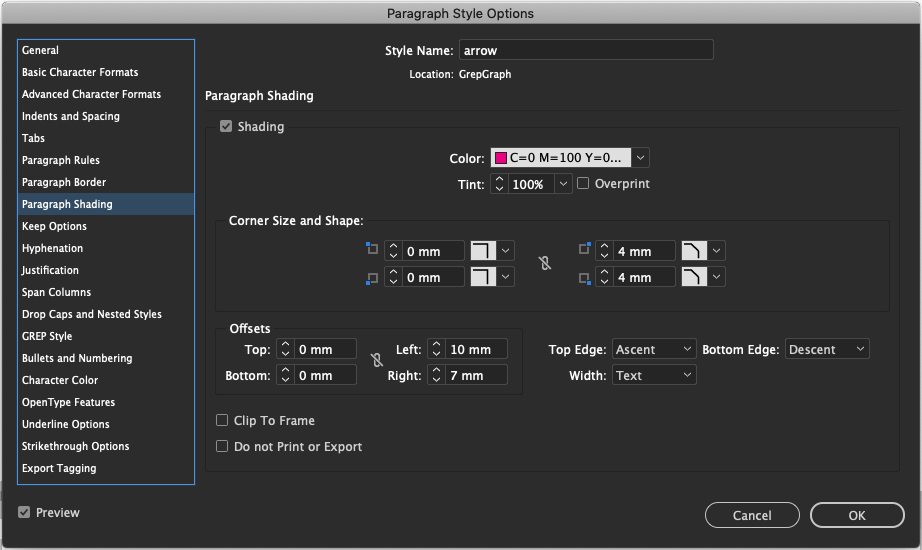

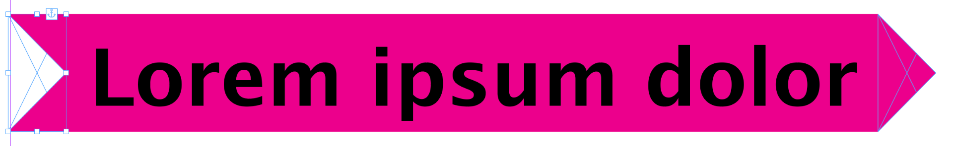

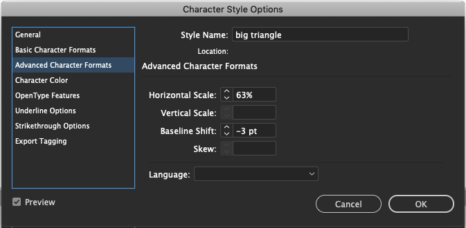

I was able to do it with a combination of paragraph shading, bullets and numbering and the right glyph to use at the front:
make a paragraph style that contains paragraph shading as follows, making sure the corner size/shape are set for the top and bottom right, but not the top and bottom left:
then apply bullets and numbering. I'm using a right-facing triangle from Wingdings 3.
the character style "big triangle" has also been set to match the height of the shading and pointiness of the arrow on the right side of the text.
Feel free to adjust this to your liking so it works with your design.

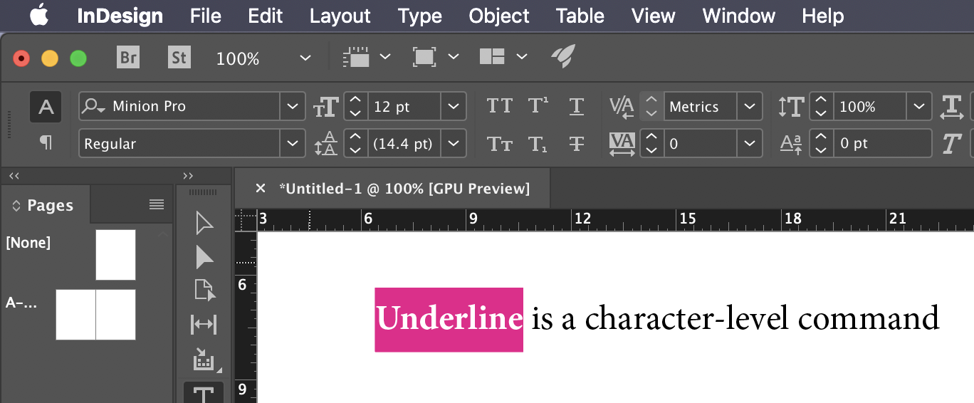

Hi bha$kar:
My solution above, would also work if you use an underline instead of shading. Shading is a paragraph-level command, meaning it will always impact the entire paragraph. An underline is a character level command that you can assign only to the highlighted text. This will allow you to assign the ribbon to selected words within a longer paragraph.
That said, I think the glyphs will be easier to work with than the anchored frames I originally suggested. Uwe has this process outlined above but doesn't explain how to define with a custom underline so I'll add that below:
Underline the text with the T button on the Control panel:
Alt/Opt click the  T button on the Control panel and set the underline options.
Finish formatting the underlined text and save it as a Character style for rapid application.
~Barb
