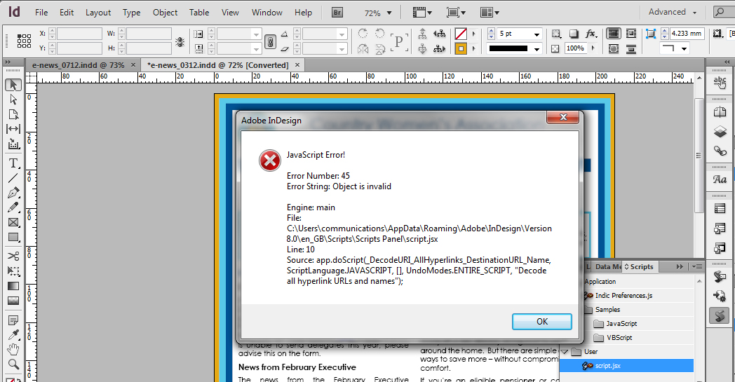

Explorer ,
Jul 08, 2012 Jul 08, 2012
Copy link to clipboard
Copied
I am running on Windows 7. I copied and pasted the script into notepad and saved as a .jsx document. Found the scripts folder, pasted it in there and ran it through the scripts panel in InDesign. I don't know much (or anything) about scripts so I don't know if I did something wrong along the way.
And yes, the bug is on the Windows version.
Below is a screenshot of the error. Not sure if you can see much of it. But you might notice the tab opened at the top which opened itself when I ran the script.
Thanks for the link to the bug report page.
Votes
Copied
@Aussie_leah – hm. This is rather unusual… I mean the tab with the "[converted]" document, that was opened immediately after starting the script.
"[Converted]" indicates, that there is a version from an older InDesign and opened. Why? I don't know…
Can you tell us more about the files you are working with and your workflow? The "e-news_0712.indd" and the other one converted. Did you open them from an older version of InDesign? Which one? Or, more important, are there other 3rd-party plug-ins installed?
The error message shown is unspecific, because I wrapped the whole functionality inside a function which in turn should be envoked by a "app.doScript()" function with some parameters, so that all actions can be made undone.
But before that, give my script another try.
But before doing that, export your InDesign file "e-news_0712.indd" to IDML, open that again in InDesign and run the version of my script against it.

Cannot test that, did not install CC …
Uwe
