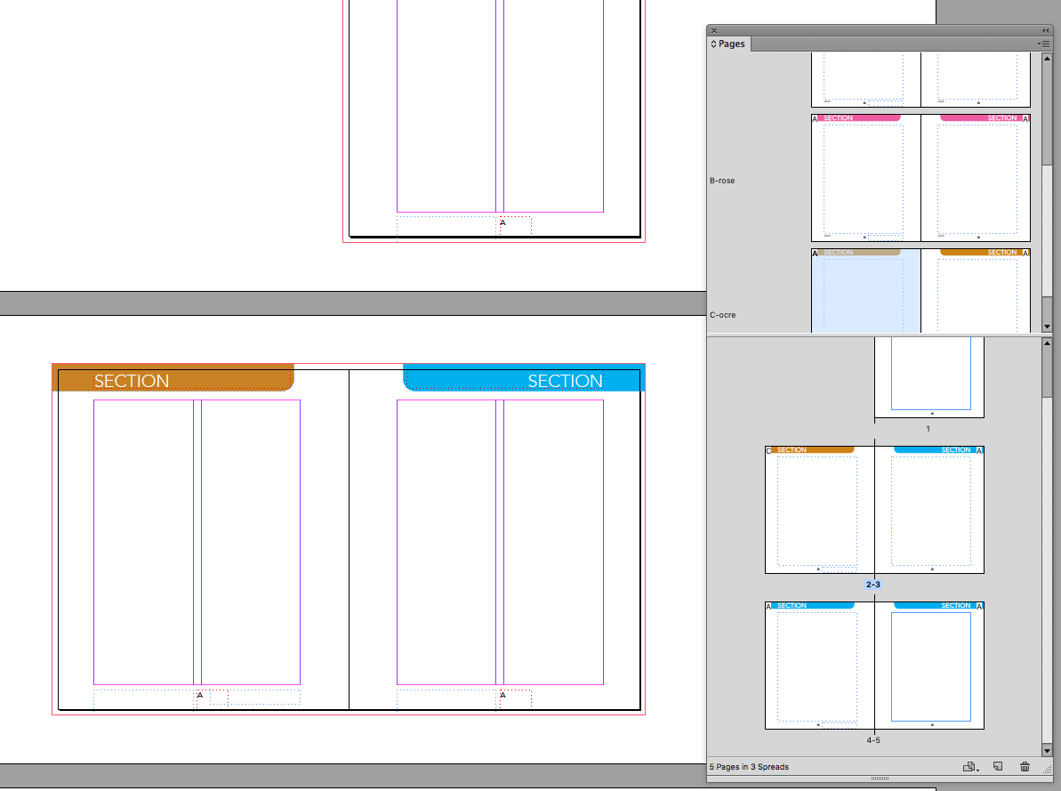

Simple facing document with one master page A (facing pages) and two master pages (facing pages) based on Master A.
Master page A applied to all pages.
WHEN APPLYING Master page B on a right page, one element disappears on the left page???
Been trying to find a solution for over a year. In it again now, and still cannot find a solution.
Please help! My students are near an exam, and the Based on option is necessary.

Hello Steve!
Here is my document : Dropbox - C17-exercice SECTION.indd
And a video demonstrating my problem : Dropbox - feb162018-masterPAGE InDegisn problem.mov
Not the first time this happens. As if the «Based on» doesn't work properly.

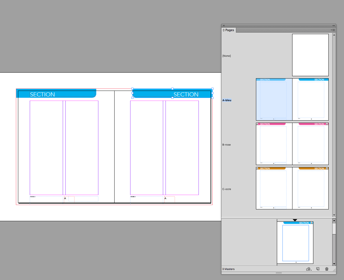

Hi mac_csrs :
I don't see any reason for this to happen, but I was able to reproduce it in the file you posted.
  • I broke the link between A and B (basing B on None) and it worked correctly, as you described above.
  • I relinked them (basing B on A) and the problem was resolved for B, but C was still an issue.
  • I broke the link between C and A (basing C on none), tested, and then relinked C to A or B, and I couldn't make the issue happen again.
Try basing both B and C on None, and then relink them to A and let us know if that takes care of it.

Hi Danielle:
I guess I wasn't clear. What worked for me was unlinking— and then relinking—the master pages. When I did that:
  • A-Master is the parent
  • B-Master is relinked to A
  • C-Master is relinked to A (or to B)
Once I did that, the file worked as it should have from the beginning. I think there was an issue with the file, and not an issue with InDesign.

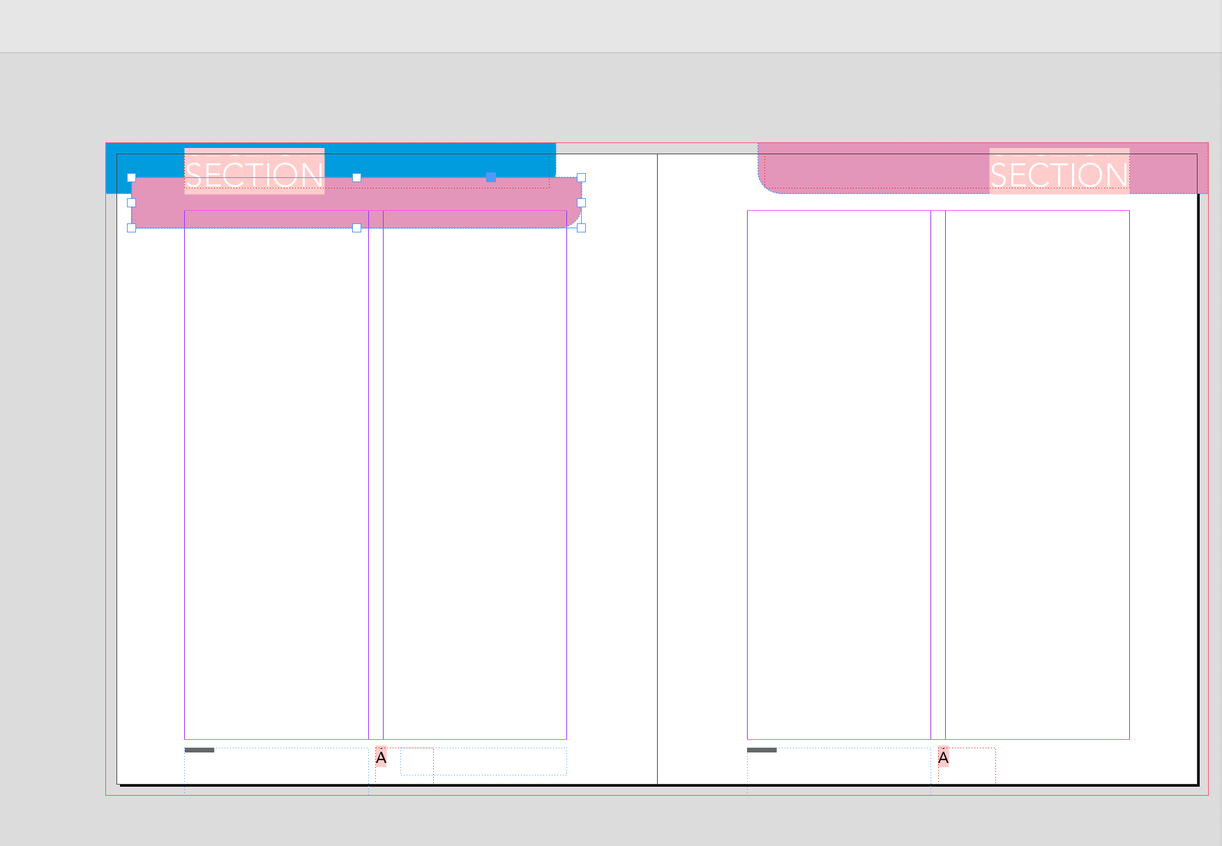

I tested it again... and realized it works when delinking and relinking BECAUSE by relinking, the elements of A-Master is copied under the colored blocks of B-Master (two colored block are superposed).
Dropbox - testing BASED ON no2.indd
https://www.dropbox.com/s/1xklh5xkewvwr0y/testing%20BASED%20ON%20no2.indd?dl=0
In this new document, I was able to see it because I modified the shapes of my blocks.
I am not sure the file is the problem, because since last year it always happens when I or my students use the «Based on» option in any InDesign documents. Maybe it is our method of doing it?

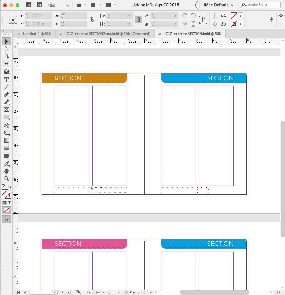

It is a bug like behavior and it doesn't appear to be limited to your doc or CC2018. I was able to replicate it by building a new doc with 2 masters based on A.
I can fix the problem by dragging the left and right blue boxes on Master A out of the bleed and then putting them back in place. So:

I just checked your file on my 2018 test volume and didn't have any problem applying the masters. Have you tried resetting your preferences and caches? Try the caches first.
Have you checked the fixed file I posted at the end of #10

The only problem with relinking is that, with that particular design of colored elements of the same shape and size, is that there is a copy of the rectangle from A-Master being placed under the old one. If the shape of the B-Master is modified, you can see the duplicate under.
