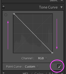

You can use the Tone Curve to invert images.
Click the icon to enable Point Curve editing. Drag the corner points to their opposites.

Apparently, Custom Point Curve is no longer available in LR 6.5
Likes
Apr 13, 2016 Apr 13, 2016
Copy link to clipboard
Copied
Yes it is. Just click the icon and adjust the curve.
The word "Custom" doesn't appear until you start manipulating the curve.
Likes

What icon? Also, I can't select RGB, it only has contrast adjustments. Using Lightroom 6.5 (NOT CC)
Likes
Copied
See reply #1 in this thread.

OK, got it, the little curve icon. Thanks. I have been able to convert a film color negative (shot using a digital camera, bellows, macro lens, and slide duplicator) to a positive image in LR. And saved it as a preset.

Good catch by Per.
You need to click the icon so that the sliders are not shown. Then you can move the endpoints.
