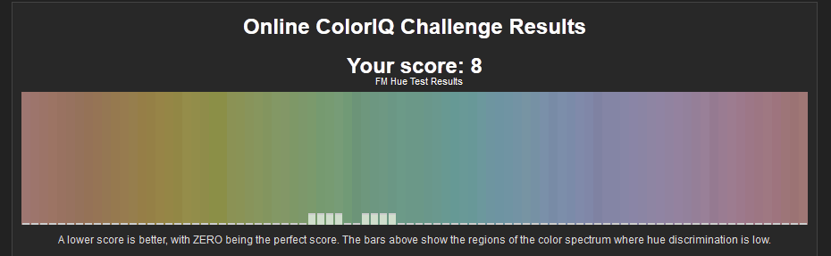

Interesting test. Here's mine:
As a 50+ male that's supposedly pretty good, but still it's interesting that the errors are lumped in the same part of the spectrum.
(I did get distracted by the fact that some of the patches are noticeably darker than their neighbors, and that threw me off a bit).
