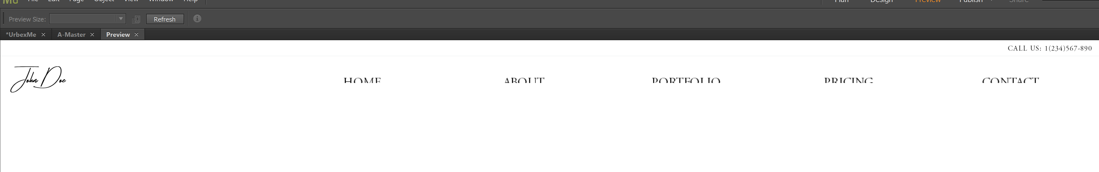

Hallo All..
I'm trying out Muse and so far I have really enjoyed the experience, but there is this one thing.
When I make menus with unifrom size and responsive width, the text get all screwed up when I preview in Muse and browsers.
I'm pretty sure It's the 4k resolution and/or Windows High-DPI Interface Scaling, since when I set the screen down to 1920x1080 everything seems to be fine.
I really hope I'm doing something wrong or there is a way to fix it, besides not using 4k screen.
I hope that someone smarter then me can help with this problem.
This is Uniform Size and Resize set to Responsive Width:
And this is Unifrom Size and Resize set to None:

LEGEND , Jul 13, 2017 Jul 13, 2017
Did you use system fonts for the menu?
Did you expand the page to browser width by clicking onto the small double arrows ("<<") to the left/right of the breakpoint bar?

When I change the "<<" to ">>" it looks like this:
Better, but still not really what I was looking for.
The font is Adobe Garamond Pro.
I haven't tried changing it, but I will try it and se if that does anything. 😃

It was apparently the font.. Changed it to Arial, and everything is working now.
Thank you soooo much! Didn't even think of it being the font.. And It was really getting on my nerve!

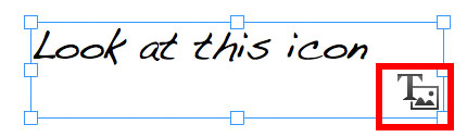

Perhaps it may help, to know the reason, NXID​:
Muse can’t know, which fonts are installed on the machines/devices of the visitors of your site. That is why it has to convert system fonts to images. Therefore (and for other reasons) always use standard fonts (are supposed to be installed on every machine) or web fonts, which will be loaded to your visitor’s machine temporarily, when they open your site.
When a textbox with a system font applied has to be converted to an image, this image is scaled proportionally (as images do), when the browser is resized. In opposite to that, „normal“ text elements don’t scale proportionally, but only horizontally. This difference causes the different appearance of fonts, which you are encountering.
1. If a text box will be converted it is indicated by a small icon bottom right of the text element:

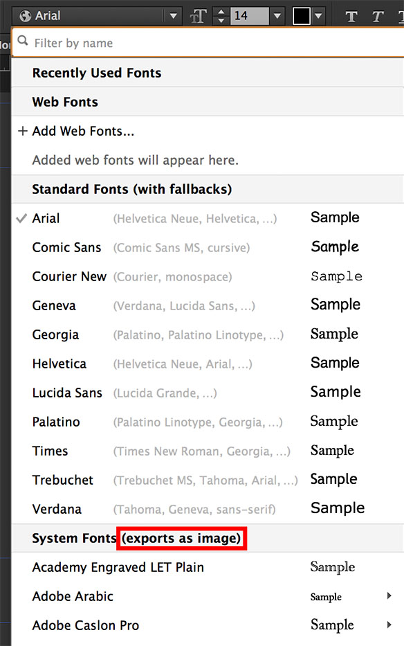

2. If you have a closer look into Muse’s font menu, you will notice, that the behaviour, I described, is indicated there too:

That means:
  • Fonts remain font if you use „standard fonts“ (they are considered to be present on every machine/device); If they aren’t , browsers use similar fonts („fallback fonts“)
  • Fonts remain font if you use „web fonts“  (self hosted or hosted by TypeKit or Edge). These fonts are temporarily uploaded to your visitor’s machines to display the site correctly.
  • Fonts are converted to an image, if you use „system fonts“, because it can’t be guaranteed, that these fonts are installed on your site visitor’s machines/devices. And since an image scales differently as a text box does (images scale proportionally, text boxes only horizontally), your page will necessarily get mixed up, when you resize the browser window.
In summary: The problem in question has nothing to do with font quality, but only with a correct usage of your fonts.
More informations here: https://helpx.adobe.com/muse/using/typography.html
  • Are you definitely sure, that you choose the „Arial“ from the „Standard Fonts“ section of Muse’s font menu? Many systems have installed more than one „Arial“ and that will cause problems.
  • Are you sure, that your text box isn’t marked with the „text conversion icon“ (See above)
  • Are you absolutely sure, that there is no single character (a „.“ a blank or whatever) left in your text box? One system font character will cause conversion.
  • When you preview your site in browser, are you able to select characters, words, paragraphs on your page or are you only able to select the complete text box? In the last case, your fonts are converted to an image.
