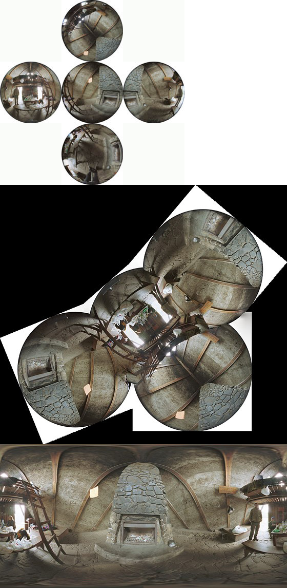

You may be able to import what ICE saves as a 360 Spherical projection via menu 3d>Spherical Panorama>Import Panorama...  in the import dialog enter the number of pixels in the ICE file width and height  and Patch its hole than export the patched 360 Spherical Panorama.  I would imagine that ICE file has filled the hole with a solid color.
When I tried stitching fisheye images with Ice the middle stitch is what ICE gave me the bottom what Panotools via PTAssembler gave me

It more like it can not stitch the poorly captured images you tried to stitch Ice Also can not perfectly stitch the image  for you either for you need to patch what Ice give you in Photoshop. ICE did this stitch for me I found is unusable.
I was able to stitch the images with other software designed for stitching images that has better lens support.  The image were captured to be stitched together.  It just that  ICE and Photoshop do not support all lens types well.  So its not  a case of Garbage in Garbage out.  Its Good Input Poor Processing  Garbage out.
View the Stitched 360 Pano in a Window here
