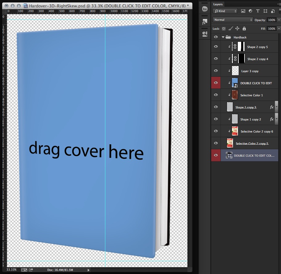

Yes - sort of - thank you!  My ultimate goal in all this is automating each type of mockup we need to create (CD, DVD, Blu-Ray, Book, all different facings, etc).
I am using a script (that I believe you wrote) but I can only use it for certain circumstances (and for paperback right facing books only) because sometimes I would need to create the spine of the DVD, book, or side panel of the CD, which would involve more than one smart object and creating those elements would take just as much work on my end creating the folder of files than scripting would help.  I replaced what you suggested in the other thread and it works now with selecting items in a folder.
For a hardcover book facing right, There is only ONE more step I would need to add to the script to make this type of mockup fully automated and that is to have the option to change the color of the little bit of back cover that's showing (the highlighted layer in the example below) Which would involve just a dialog to modify that one layer.  I would need to be to select the new color (to match the cover, obviously), and then the script can continue on with saving the new PSD as normal.
Any suggestions on how i can add to this script to be able to change that layer?  I don't want to get too complicated with all of this, but we do this EVERY MONTH so it would be of great use to us.
Thanks in advance for sharing your knowledge with the Adobe community!

What are the unmistakeable characteristics of that Layer?
It seems to share its name with another one, but is it always the lowermost Layer?
Or at least the lowermost Solid Color Layer?
Votes
Community Beginner ,
Jan 31, 2014 Jan 31, 2014
Copy link to clipboard
Copied
It is always the lowermost layer and always a solid color.
Here are it's properties:
Thank you for your time 🙂

if ($.os.search(/windows/i) != -1) {var theFiles = File.openDialog ("please select files", "*.psd;*.tif", true)}
else {var theFiles = File.openDialog ("please select files", getFiles, true)};
if (theFiles) {
// work through the array;
          for (var m = 0; m < theFiles.length; m++) {
// replace smart object;
                    theLayer = replaceContents (theFiles, theLayer);
                    var theNewName = theFiles.name.match(/(.*)\.[^\.]+$/)[1];
//Raise color picker for Back cover;
try {
app.activeDocument.activeLayer = app.activeDocument.layers[app.activeDocument.layers.length - 1];
var idsetd = charIDToTypeID( "setd" );
var desc7 = new ActionDescriptor();
var idnull = charIDToTypeID( "null" );
var ref2 = new ActionReference();
var idcontentLayer = stringIDToTypeID( "contentLayer" );
var idOrdn = charIDToTypeID( "Ordn" );
var idTrgt = charIDToTypeID( "Trgt" );
ref2.putEnumerated( idcontentLayer, idOrdn, idTrgt );
desc7.putReference( idnull, ref2 );
var idT = charIDToTypeID( "T   " );
var desc8 = new ActionDescriptor();
var idClr = charIDToTypeID( "Clr " );
var idsolidColorLayer = stringIDToTypeID( "solidColorLayer" );
desc7.putObject( idT, idsolidColorLayer, desc8 );
executeAction( idsetd, desc7, DialogModes.ALL );
} catch (e) {};
//save jpg;
                    myDocument.saveAs((new File(thePath+"/"+theName+"_"+theNewName+".psd")),psdOpts,true);
////// get psds, tifs and jpgs from files //////
function getFiles (theFile) {
     if (theFile.name.match(/\.(psd|tif)$/i) != null || theFile.constructor.name == "Folder") {
          return true
////// replace contents //////
function replaceContents (newFile, theSO) {
app.activeDocument.activeLayer = theSO;
var idplacedLayerReplaceContents = stringIDToTypeID( "placedLayerReplaceContents" );
    var desc3 = new ActionDescriptor();
    desc3.putPath( idnull, new File( newFile ) );
    var idPgNm = charIDToTypeID( "PgNm" );
    desc3.putInteger( idPgNm, 1 );
executeAction( idplacedLayerReplaceContents, desc3, DialogModes.NO );
return app.activeDocument.activeLayer

This worked after I ungrouped the layers.  Thank you so much for all your help, it is really appreciated!

Hi, thank you for your solution provided here.  I tried to use the script and it takes me to the "Choose files" folder and I can't choose anything.  This is what I did.
I copied the scirpt into a text doc and named it ending with .js
I go to File > Scripts > Browse and select the script.
It first gave me an error that I wasn't selecting layer with the smart object so I choose the layer with the smart object.
After that it let me get to the "Choose files" but won't let me actually select the folder.
Here's what I need to accompliish.
I have a psd with a smart layer in 4 different layers.  I want to replace the image in that smart layer so it will replace the instances in all 4 layers.  I have 500 different images I need done so I'd like to be able to batch switch them.
Can you help?

Do you work on Mac or Windows?
Did you use the Script from post 14?
It won’t let you select a Folder but Files.
The try-clause after
probably makes no sense for you.

I have an identical requirement as www.impactcolorprint.com.
Could a folder be selected instead of individual files (selecting several hundred would be difficult)?
If our starting PSD has multiple layers of the same smart object, replacing the contents of that smart object would update them all, correct?
Lastly, I would like to see the updated PSD file saved as jpg with the originating file name from the folder we selected.

Mar 21, 2014 Mar 21, 2014
Copied
When replacing a Smart Object all its instances should update indeed.
Selecting a Folder instead of Files can be done by changing the corresponding lines to
var theFolder = Folder.selectDialog ("select folder");
if (theFolder) {
var theFiles = theFolder.getFiles(/\.(jpg|tif|eps|psd)$/i)
Saving jpgs can be done directly or with a function like this:
function SaveJPG(saveFile, jpegQuality){
jpgSaveOptions = new JPEGSaveOptions();
jpgSaveOptions.embedColorProfile = true;
jpgSaveOptions.formatOptions = FormatOptions.STANDARDBASELINE;
jpgSaveOptions.matte = MatteType.NONE;
jpgSaveOptions.quality = jpegQuality; //1-12
activeDocument.saveAs(saveFile, jpgSaveOptions, true,Extension.LOWERCASE);
but you need to use the correct path as the »saveFile«-argument.

Thanks for the great feedback. I have it working beautifully.
One last question...
My images vary in width and height. I would like them to be maintain their aspect ratio, while fitting the shortest side (width or height) of the smart object it is replacing (which is a square).
Ideally I'd like the new images to have white space on top and bottom or the sides but not exceed the bounds of the original smart object in the template.
Is this possible? I'm assuming any manipulation would be done right after the "executeAction(idplacedLayerReplaceContents... " command.
Is there a way to do this?
I think there is a basic problem here with your understanding of how smart object layers work.
The layer embedded object what ever it may be.  Has pixels  rendered for it for the smart objects layers content and there is and associated transform for the layer.   These pixels are protected from change you can not directly alter them.  When you change the layer size you do it by altering the layers transform.  You can also attach smart filters to the layers content and mask the layer. You can not use tool on the layers that alter pixels no paint, erase,  lines etc.  If you use layer duplicate to dupe the layer the dup layer shares the embedded object.  You can transform  layers that share an embedded object to form a picture package the changing each layers associated transform. To different areas over the documents canvas.  When you replace the shared embedded smart object all the layers that share the object change.  The associated transforms are not changed. If you do not replace the current embedded object with an object that is the same size the smart object layers associated transforms will not work the way you would expect then to work. For the were set for a different size object.
If you know the output area size and its location you should be able to script what you want. I would think after you replace the embedded content. You could set the layers transform to 100% width and 100% height get the layers bounds and calculate the required transform. for the output area. I do something like that in my collage package.  However I resize the image to fill the output area and mask off any excess image so the image get aspect ratio of the output area and looks like a centered crop.
However from the example template in this thread there look to be a perspective transform involved which may have some rotation. I have never tried to program in the ability to handle rotation and prospective placement of images.   I just tweak the populated collage manually if an image or two need that type of transform.
JJMack

I have managed to solve for this by evaluating each smart object after it is replaced and scaling it in the parent PSD. Works perfectly)! Thanks again for the feedback.
What I had hoped for was the ability to manipulate the new smart object contents to fit the starting size of the initial, embedded smart object.
Here's an example PSD file — On it, multiple layers of the same smart object (in green).
The smart object is originally 200 x 200 px.
Now, using a folder of images, I swap out the contents of the green smart object.
The logos vary in width, height, and pixel size - so when the script is run they can sometimes exceed the bounds of the green boxes in the native document.
Again, I have solved for this by evaluating each layer after the SO has been updated with each logo, and back in the parent PSD.
But, what I was most curious about was if it was possible to do this during the manipulation of the smart object and immediately after/during "executeAction( idplacedLayerReplaceContents, desc3, DialogModes.NO );" Thus placing a logo which is already "fitted" to the green area, without stretching the logo (beyond the transform of the parent PSD).

I would recommend a different approach:
Open the SO, place and if necessary scale the replacement files there, hide the background and save/close the SO.

That was my initial though. But can that be done? How? I havent been able to target the SO after it is replaced.

You’d have to foregoe the replacing and instead open the SO, then place the file.
Something like this – if you have the Preference set to scale placed SOs (»Resize Image During Place«) this might suffice, otherwise you may have to scale the newly placed SO in the SO.
