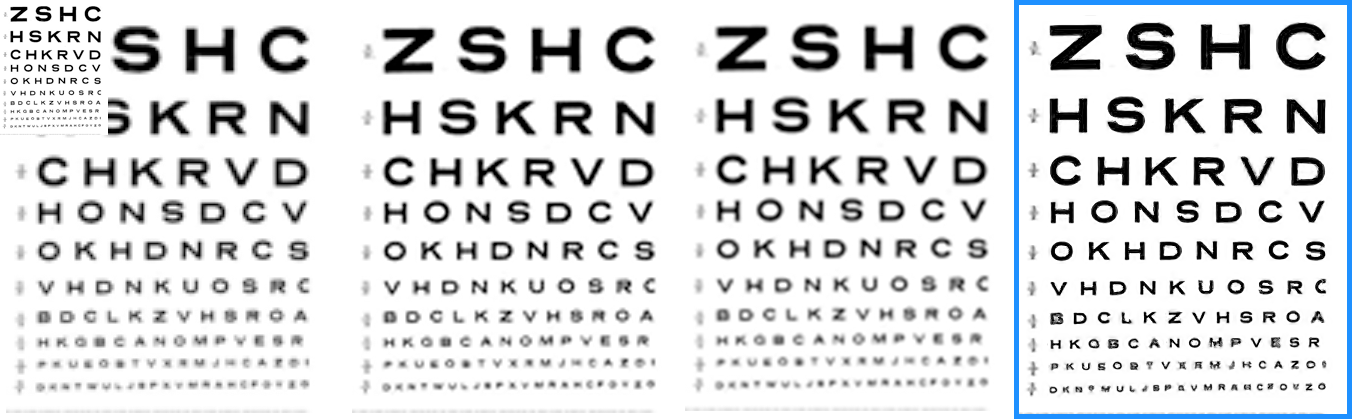

This was linked from a flickr group, and I am not sure how new the paper is, but it is very impressive. I didn't even try to read or follow the complicated bits, but it compares various up-scaling methods with what they are calling a Super Resolution method, and the difference is amazing.
http://www.wisdom.weizmann.ac.il/~vision/SingleImageSR.html
ISTR that it was a couple of Weizmann Institute guys that first demonstrated Content Aware Scale/Fill, so - if that is right - they probably have a relationship with Adobe.  Something for the next Adobe Max perhaps?

Adobe may have see it however I just did a test using one of the example on the web page the eye chart. the origanal upper left corner on to one of Adobe biliner to the right Adobe Bicubic Sharper right of thatr CS6 Bicubic Automatic then their with a blue border.
Png next if it works
