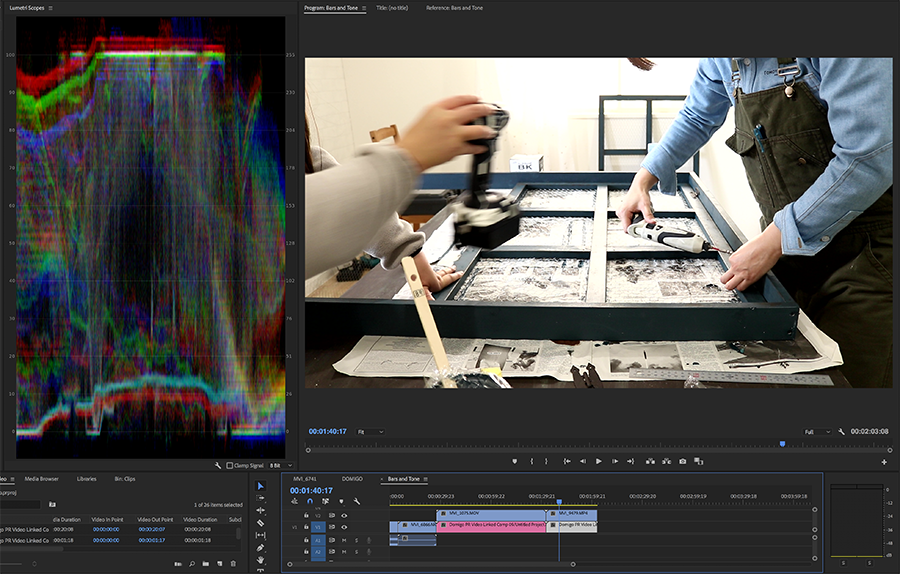

Hello everyone, I have been using the new iMac Pro and have been experiencing these issues regarding an added high contrast from time to time and thought I was going crazy. Has anyone figured out a solution to this, or is it just a bug.... I work on the same exact project on an older iMac and the color is fine, totally matches how it was shot.
My System Info:
iMac Pro
High Sierra v.10.13.6
3 GHz Intel Xeon W
64 GB 2666 MHZ DDR4
Radeon Pro Vega 64 16368 MB
Premiere v.13.0.1 (PICTURED ON THE LEFT)
AfterEffect v.16.0.0 (PICTURED ON THE RIGHT) CORRECT EXPOSURE
Nothing has been added to the footage in premiere, so I cannot understand how its being interpreted this way upon import.
Votes
LEGEND ,
Nov 14, 2018 Nov 14, 2018
Copy link to clipboard
Copied
In your new Mac, I'll assume it's a P3 wide-gamut monitor, and you've not set the Preferences option to "enable display color management" ... try that and see if it helps.
Neil
