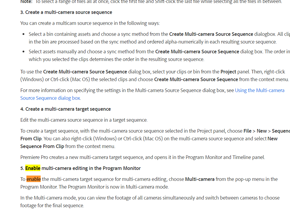

Nov 04, 2016 Nov 04, 2016
Copy link to clipboard
Copied
Does that mean you have it working now mark?
Step 5- for to the spanner on the program monitor and choose multicamera.
Likes

Hello David Jim Simon and Jeba Joseph
There are 5 steps, not 4, as David points out. Jim and Jeba, you are both missing one step that the other has. A mix of your steps is the right way, ie
You have to enable the program monitor AND you have to R-mouse click on sequence and choose Multicam>enable
Thanks all, working fine...
Mark.

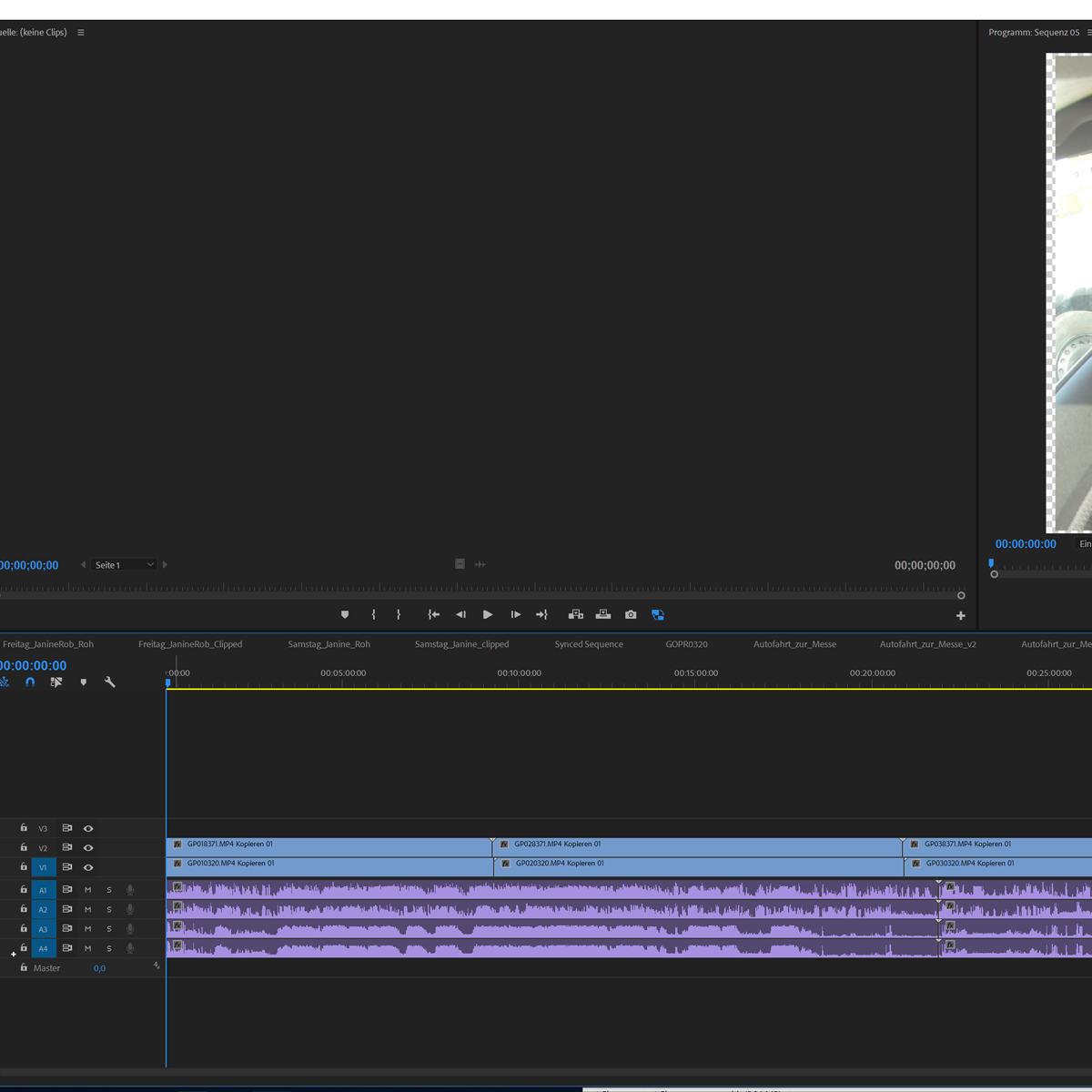

I need help concerning a multicam sequence.
I synced them manually in a sequence and followed the steps above.
My problem, Premiere nests the Audio, but I need 4 seperate tracks in my Multicam Seq.
Thanks for your help.

LEGEND ,
Mar 06, 2018 Mar 06, 2018
Copied
You should start a new thread.  This one's not really a catch-all troubleshooter.  It's more of a user guide.
