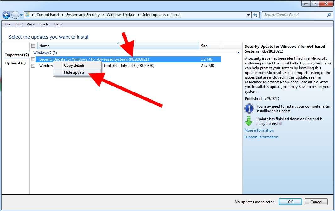

This update will keep installing itself if you have windows update enabled. You can prevent the update from happening AND keep windows update enabled. Here's how:
  1. Start
  2. Windows Update
  3. Check for updates
  4. Select important updates
  5. right click the update KB2803821
  6. Select Hide Update
Votes

Great tip marisela.  Let me add one thing.  If the update has been installed, it won't show on the menu screen under "important updates" since it's already been installed.  You have to first unintstall it, reboot, and then it will show up as an "important update."
Then you can hide it.
At least, that's what I found on my Dell XPS laptop.
