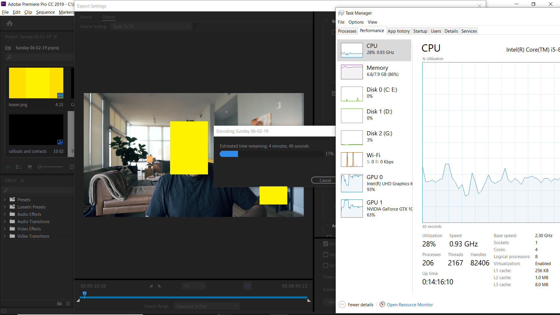

Jun 01, 2019 Jun 01, 2019
Hi everyone,
I've been looking into this matter as I have experienced this too for quite some time now....well, more like as soon as I started using the Premiere Pro. Last night, I was rendering a 9-minute video and it was using about 90-99% Intel GPU. Render setting was my usual resolution and VBR 2, and it was taking longer to render, and I have experienced faster render with similar length videos.
This morning, I tried rendering a new one as I had to revise some details in the video and I tried the CBR, and wouldn't you know it, it started using the Nvidia GPU and improved rendering speed. I normally use VBR 1 for my clients as the videos I do are mostly are published online, VBR is normally better for compression.
*Extra.... I just did another rendering and I found out that if my laptop was plugged in while rendering, it was only using 20ish% of the dedicated GPU. My adapter was becoming a little bit hot so I unplugged it and the dedicated GPU usage jumped to about the same as in the picture.
Adobe Employee ,
Jun 07, 2019 Jun 07, 2019
What are you encoding to and from? What (if any) effects are on the timeline?
Nate
New Here ,
Jun 11, 2019 Jun 11, 2019
2 adjustment layers. 1 for exposure and colour correction, and then 1 for a LUT.
And then I have several animated text graphics and an overlayed b-rolls spread across the timeline.
I'm encoding it to a .h264, 1920x1080, 23.976 fps, CBR 15mbps.
Adobe Employee ,
The Nvidia GPU will accelerate the effects, the Intel chip accelerates H.264 encoding. What version of Premiere are you using? 13.1.2?

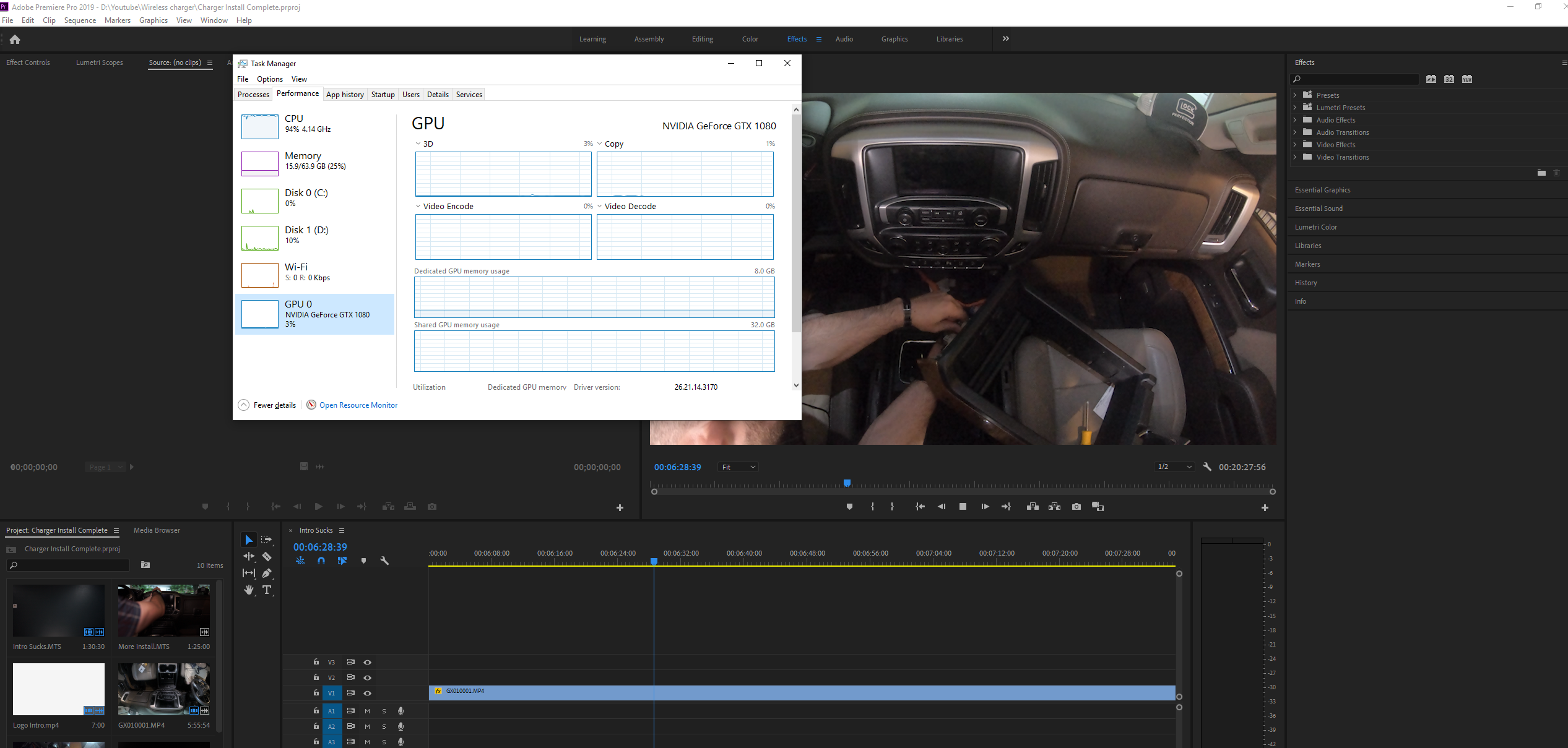

Aug 06, 2019 Aug 06, 2019
I am having the same issue everyone else is reporting. Even just trying to play back video before rendering, premiere is relying solely on CPU, and not using my graphics card at all. I have followed everyone's suggestions to no avail.
Intel 7700k
GTX 1080
64GB Ram
LEGEND ,
Well ... I don't know how many times it needs to be said ... Premiere does NOT use the GPU very much if at all for general playback ... the GPU is primarily used for those things on the GPU Accelerated Effects List ...
