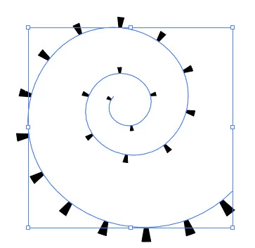

如何让图像沿着路径缩小,但不变形,且可以偏移?
你看,三角形缩小后变粗了,而且无法隐藏下半部分。

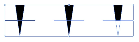

    Shape
    1. Make the triangle. Make a horizontal line. Align their centers. Give the path no stroke. Use the Shapebuilder Tool to separate the lower section of the triangle, but don't delete it. Fill the lower portion of the triangle with no fill and no stroke.

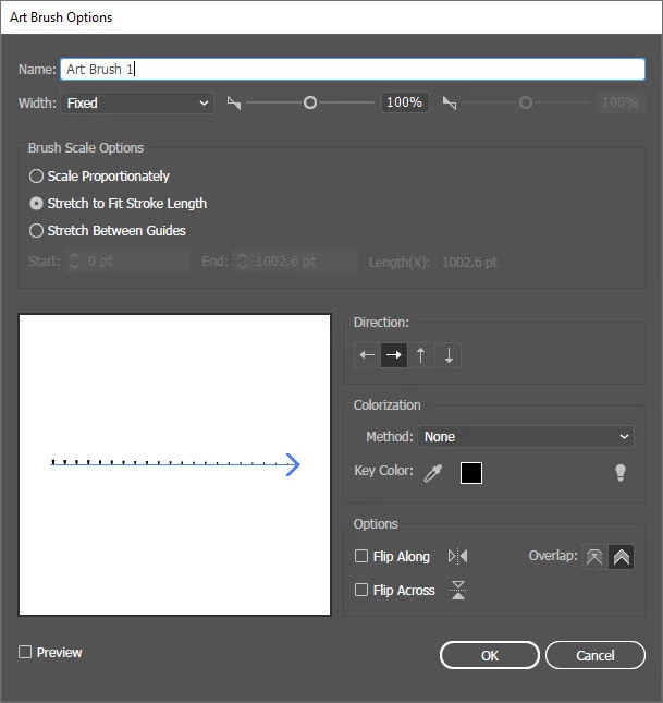

    I'm recommending a brush instead of a blend because when I tried to replace the spline, the orientation of the triangles wasn't what I think you wanted. So take the entire blend and make an art brush.

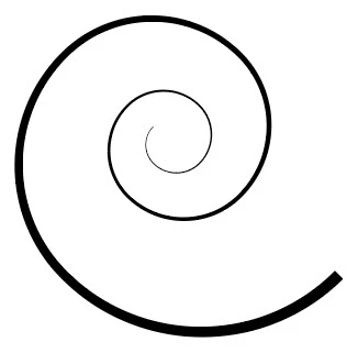

    Make your spiral with the Spiral Tool and make a copy of it. On the first spiral, apply the brush.

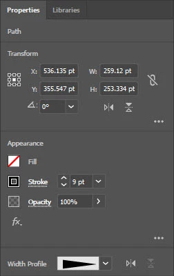

    On the second copy, use Width Profile 4 in the Variable Widths Profiles and set the stroke big enough to see the change in size.

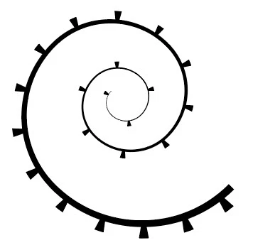

    Now align the vertical and horizontal centers of the 2 spirals.
    I hope that helps.

    Edit: At my second read, as I (mis)understand it, you wish to have the triangles point into (the centre of) the path from the outside.
    You can obtain that by mirroring each triangle vertically so that you have one triangle pointing down and a nostroke/nofill copy triangle pointing up, the two meeting at their coinciding points/tips, then align the two sets (large triangles and small triangles) horizontally.
    With this, the lower triangles (forming the lower half of the Blend) will be invisible under the spiral path and the the upper ones will be visible over (and into) the path.
