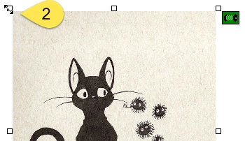

Dec 10, 2019 2:43 AM UTC
@miw_o Are you seeing this in the Robohelp editor or in the output?
If it's in the RH editor, I don't think there's any way to change it.
However, in older Robohelp versions, there were two different cursor, one when hovering over an image (1), and one when hovering over the resize nodes (2).
If you see the resize cursor when hovering over an image as in image 1 above, then it might be a bug in Robohelp 2019 New.
If it's in the output, I haven't seen this issue, but I also haven't used Robohelp 2019 New very much yet. I would suggest, as a first step, checking any image styles you have in your stylesheet, to see if a cursor is set that shouldn't be.
