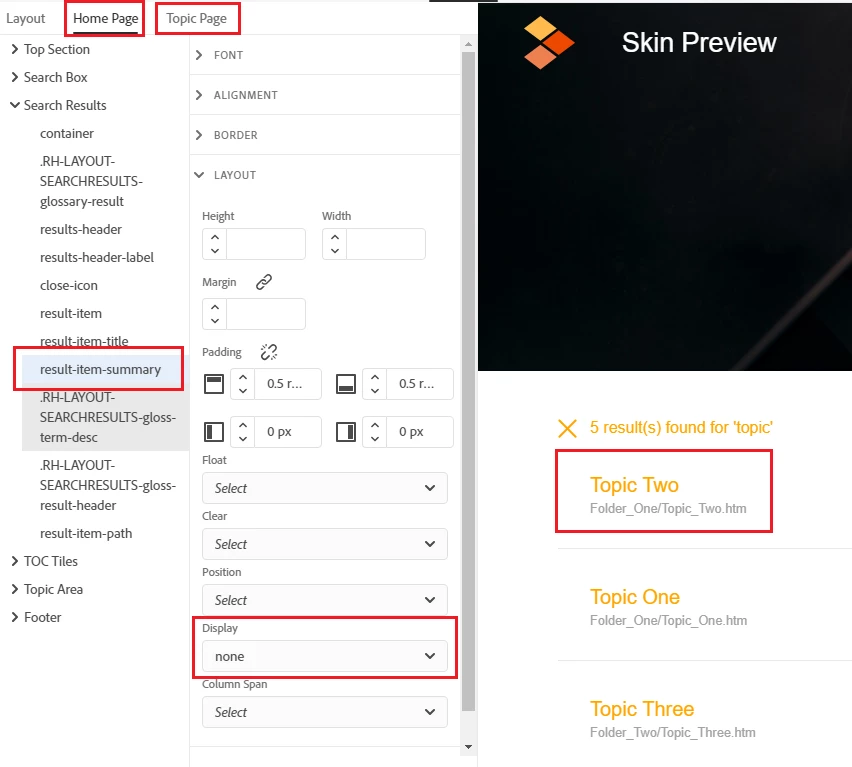

Oct 29, 2019 11:09 AM UTC
The only way I can find for Responsive HTML5 is the same method as Peter suggested.
However, if WebHelp means Frameless, then you can change it in the skin.
Open the Frameless skin. On both the Home Page and Topic Page tabs, find result-item-summary. Expand the Layout section and set display = none. If you also want to hide the path, then do the same for result-item-path in both places.
Hinkan
HinkanAuthor
Oct 30, 2019 12:13 AM UTC
Thank you Amebr.
It was very helpful!!
