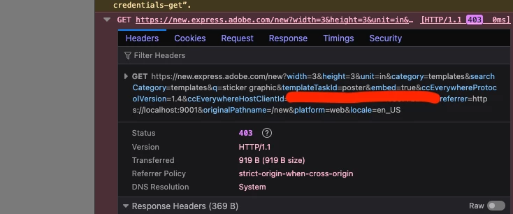

this pops up every time I try to open SDK in a localhost environment. Yes - it is set in allowed domains, yes - it has https. Could you please take a look why is this happening?
Also is there a delay time between - chanigng the allowed domaind and actually seeing the change? I did a change adding a domain I wanted to test in on the production env. It din't work out. It worked out like 15 hours later without any changes from my side. Is there a way to speed this up?
Also2, I have a feeling it's very random sometimes in terms of whether it opens or not. Like it's I'm not in a mood now, vibes off - not working. And starts working an hour after (again no changes). Is it because it's not yet review?

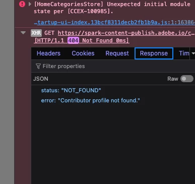

I debugged some more and looks like there still an issue witht the API key. I've no idea at this point why it's still not working. I tested the exact same settings (domain and API) with different account and it works just fine. But not here. 12 or more hours later, so I assume cache already refreshed.
// 20250220105538
// https://spark-content-publish.adobe.io/contributors/44941E7A67AF2C880A495CBC@AdobeID
"error_code": "403000",
"message": "Api Key is required"

Also is there a delay time between - chanigng the allowed domaind and actually seeing the change? I did a change adding a domain I wanted to test in on the production env. It din't work out. It worked out like 15 hours later without any changes from my side. Is there a way to speed this up?```
Missed replying to this query.  The  domains are cached for performance improvement. Usually the Cache doesnt last for no longer then couple of hours. You can always bypass this cache by connecting to any VPN to any other area.
HTH.
On a side note, please share couple of more request ids and the request URL for better triaging.

I got this
403 ERROR
The request could not be satisfied.
Request blocked. We can't connect to the server for this app or website at this time. There might be too much traffic or a configuration error. Try again later, or contact the app or website owner.
If you provide content to customers through CloudFront, you can find steps to troubleshoot and help prevent this error by reviewing the CloudFront documentation.
Generated by cloudfront (CloudFront)
Request ID: P_N7gXsnLBrkX8skJUp9bAdUMd6OzjL6keVkegKaof-tffHgCnceXw==
plus headers
HTTP/1.1 403
server: CloudFront
date: Wed, 19 Feb 2025 17:01:46 GMT
content-type: text/html
content-length: 919
alt-svc: h3=":443"; ma=86400
x-cache: Error from cloudfront
via: 1.1 bf8300a72b6d0584e2f6b1df22e3f548.cloudfront.net (CloudFront)
x-amz-cf-pop: WAW51-P3
x-amz-cf-id: P_N7gXsnLBrkX8skJUp9bAdUMd6OzjL6keVkegKaof-tffHgCnceXw==
X-Firefox-Http3: h3
Poland
Adobe Employee
February 19, 2025
Can you please share the response headers obtained during the 403 response?
Also from which geo location the invocation to express is happening?
Tx!
