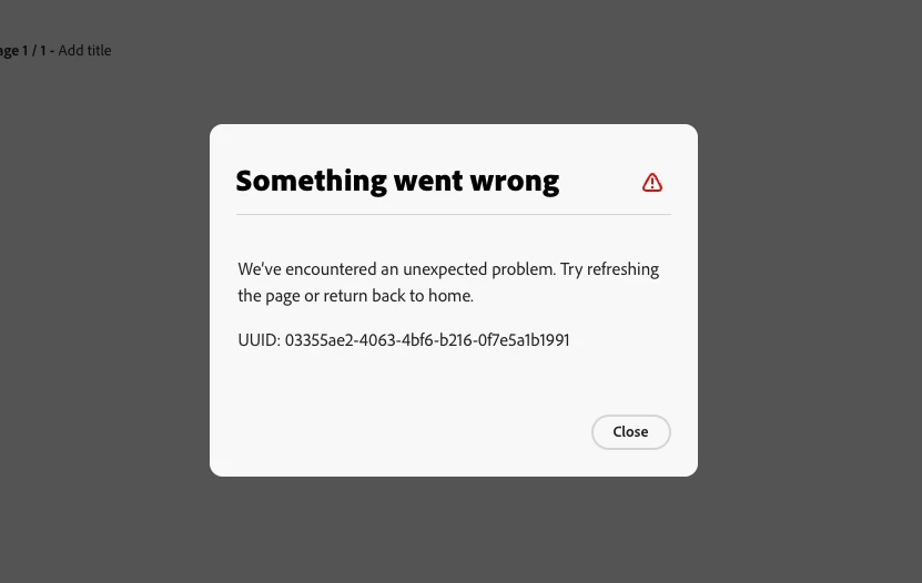

Hi, I'm trying to create project with a video by using blob type. I used createWithAsset () method with bellow configuration but the edtior show an error message and then close. So if anyone know what I did wrong please let me know, any helps would be really appericated.

    The editor should be opened with the video file but throw an error and close instead.

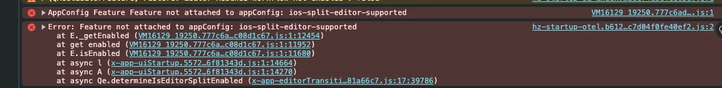

    Other error logs from my browser console:

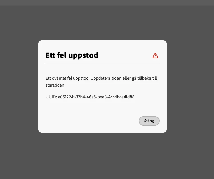

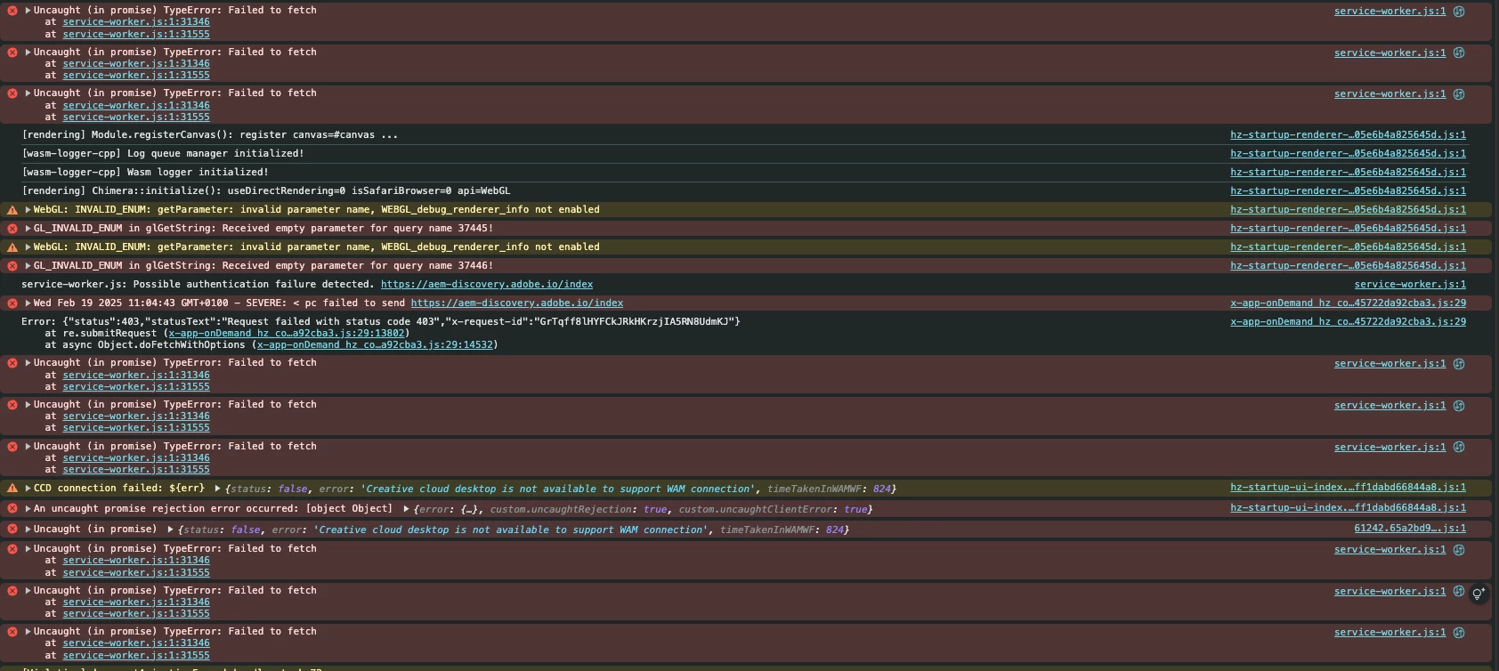

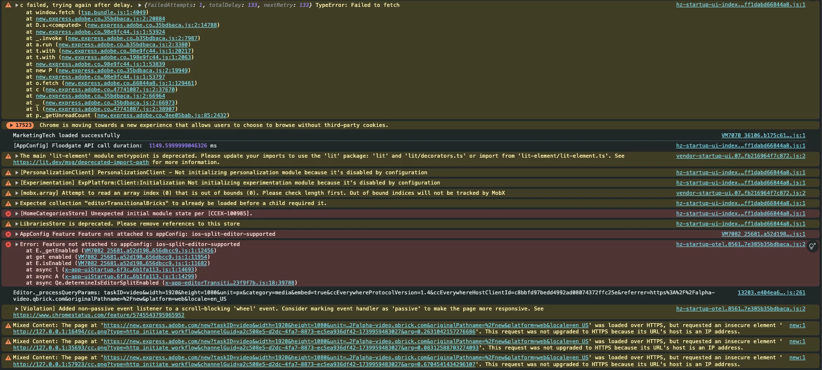

Hi, Thank you very much for your reply! I tried and it's seem have no different with last one.
I'm using v4 from this: https://cc-embed.adobe.com/sdk/v4/CCEverywhere.js
Could you please take a look if my implementation is correct? or an working example would be appericated.  🙂
Some further log screenshot from my browser if it's help:
