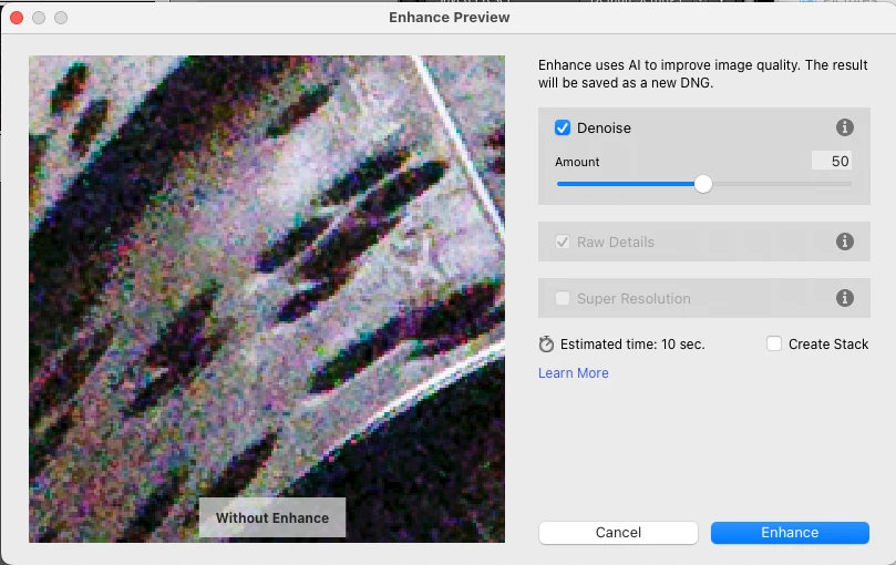

I'm not seeing any noise reduction using Denoise AI on Pentax K3iii DNG files in Lightroom Classic v12.3. Any future solution to this issue?
Thanks
Tom

Tom here, the OP - Thanks for the attention to this issue. What I'm not seeing is the fairly dramatic noise reduction and "resolution enhancement" that I have seen on other demonstrations with other (non-Pentax) DNG files on places like YouTube. If I use the manual noise reduction sliders in LR on this DNG, that seems to produce a better result than from the AI process. I have some bird photography taken with my K3iii where I can post to further determine if the Denoise AI is doing what I would expect it to do - denoise and enhance feather detail.
Dropbox link for Pentax K3iii DNG files:
https://www.dropbox.com/s/tmp78s87hudoksn/2023-04-08_Birds-7907.DNG?dl=0
https://www.dropbox.com/s/98caujm0w36dltz/High_ISO_TestShot_IMG8596.dng?dl=0
Tom

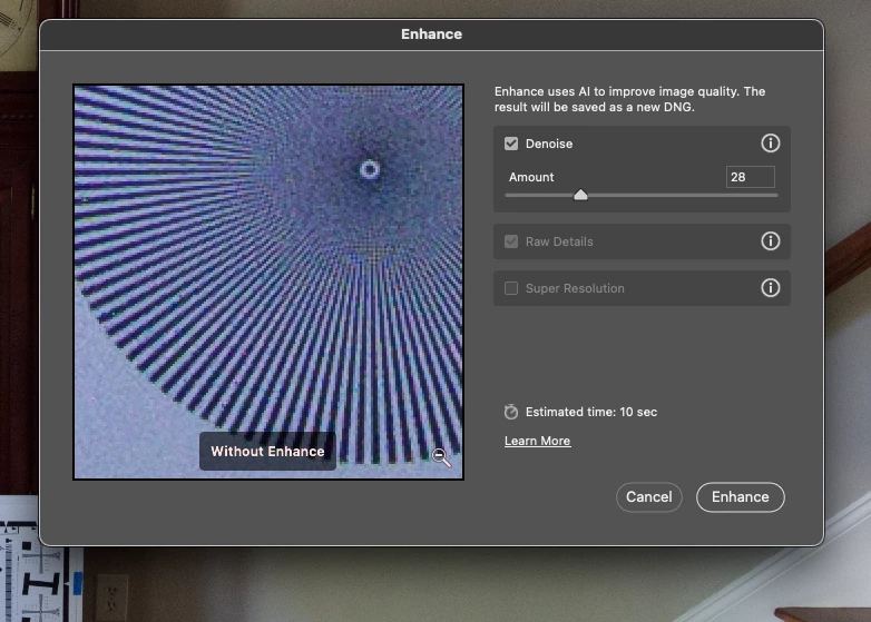

May 4, 2023 1:17 AM UTC
Looked at the file and yes indeed. It appears Lightroom is only doing the raw details step (why the target cleans up in the moiré department) and not doing anything about the noise at all. For similar files from my cameras it will easily clean up the noise completely so it appears something is tripping up the noise reduction part.

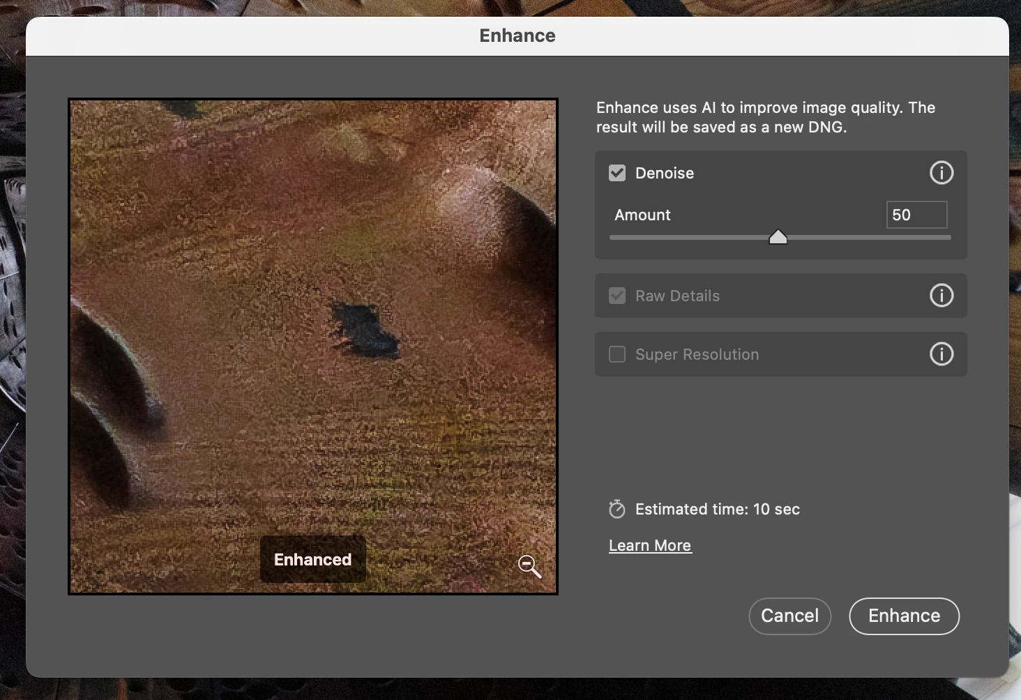

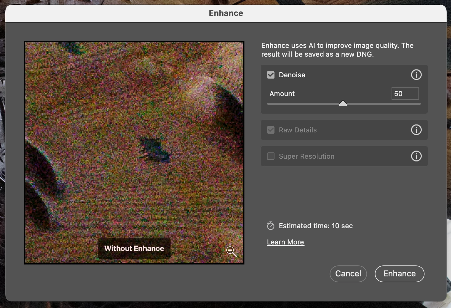

May 4, 2023 1:37 AM UTC
Interesting! Yet it clearly doesn't do it at all. Also tested the file in camera raw and it gives the same result of no noise reduction whatsoever. I also downloaded the image you linked to from dpreview and it does do a little bit of reduction there, but very badly and patchy. Far worse quality than what I get on my images (not from the same camera) and very strangely patchy and actually killing structure that obviously belongs in the image. Here for example is some woodgrain in the image @johnrellis linked to that gets pasted over by enhance (run in camera raw in this case but there is no difference with Lightroom). It have never see it do anything like this with images from my camera. In fact it often finds detail you can't even see easily in the original. Here it just pastes over the grain. Clearly it is not tuned correctly for this camera.

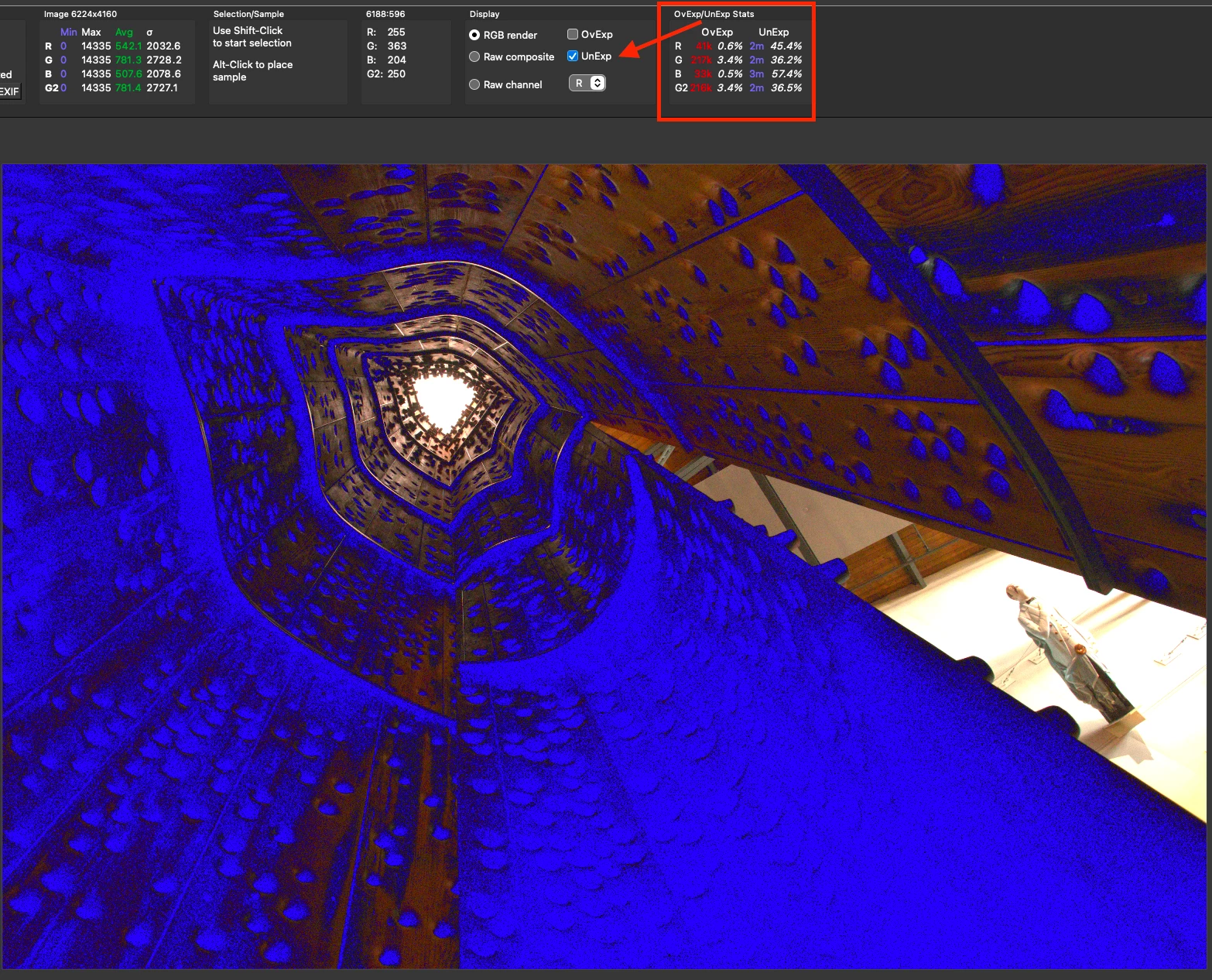

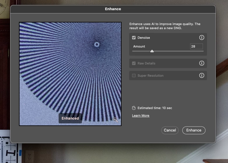

May 4, 2023 12:23 AM UTC
I got the file from Dropbox.
I'm not sure what to make of what I see. The difference between Denoise on and off is really small, but there is a difference. I see it cleaning up the moiré, so it is doing something. Is it doing enough, or what it should? I don't know.
I put the two screen captures into a folder on my Dropbox so you can view them in Photoshop up close.
https://www.dropbox.com/sh/zauhspigiqj5hxs/AAApoPfQ_eYThPzzjbUTer31a?dl=0
Can you run one more test where you crank up ISO (or just under-expose what you shot a few stops, which is producing the noise)?

And again (the ISO 32000 is moot), it IS super noisy because it is super under-exposed, which again is why I've asked the OP, who did such a great job exposing the example he provided, to do what the DP folks couldn't do.
Look at what is really happening to this K-3 raw data:
Now I'll get off my regular soap box about how high ISO has nothing to do with noise. 😜
