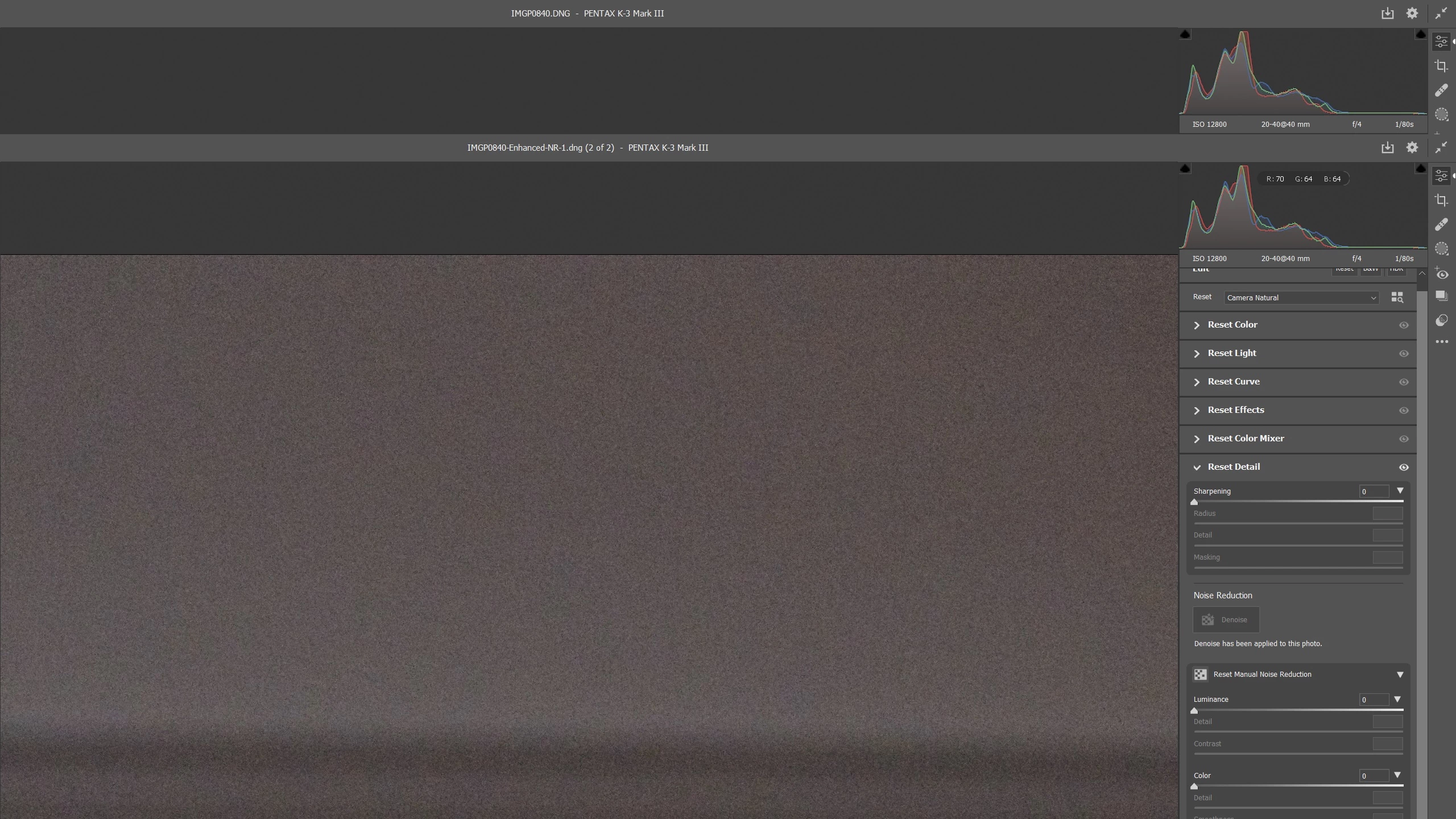

P: Denoise AI and Pentax K3 MKIII DNG files - not working
I'm not seeing any noise reduction using Denoise AI on Pentax K3iii DNG files in Lightroom Classic v12.3. Any future solution to this issue?
Thanks
Tom

Mar 16, 2024 10:12 PM UTC
@andrzejv90126968AI Denoise works on PEFs from older cameras like K-5 and K-3(1). It doesn't work (and has never worked) on PEFs from  cameras which apply noise-reduction to the RAW-files, like KP, K-1 II and K-3 III.
