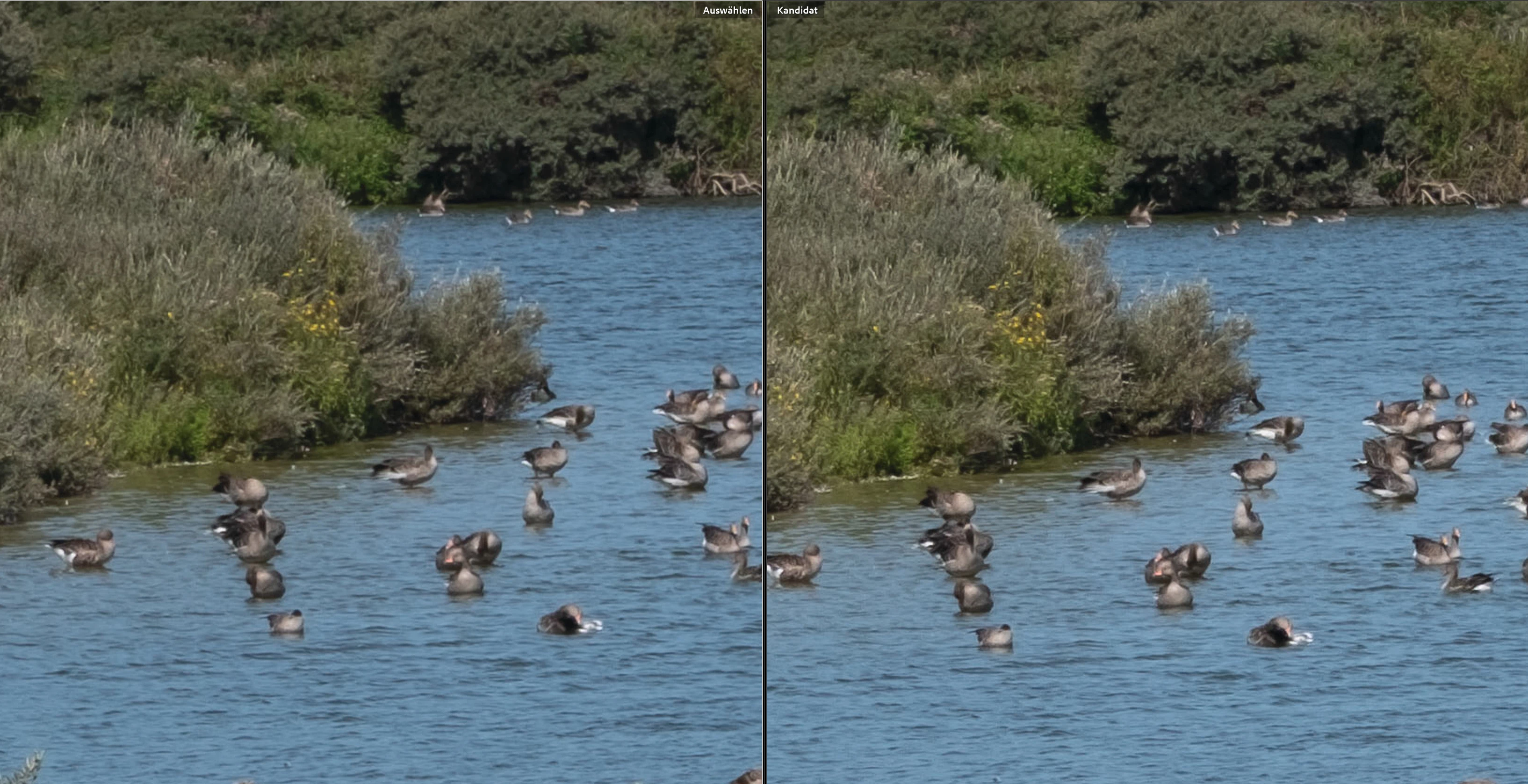

I don’t think this is actually solved. Testing this with LrC 15.5.1. I can see that for my Fuji X-T5 raws the details added by “Raw Details” DO NOT transfer to the merged panorama. Check this comparison, Left is the panorama, right is one of the source files with raw details on. I know this source file has been used since the birds moved a bit between every frame:

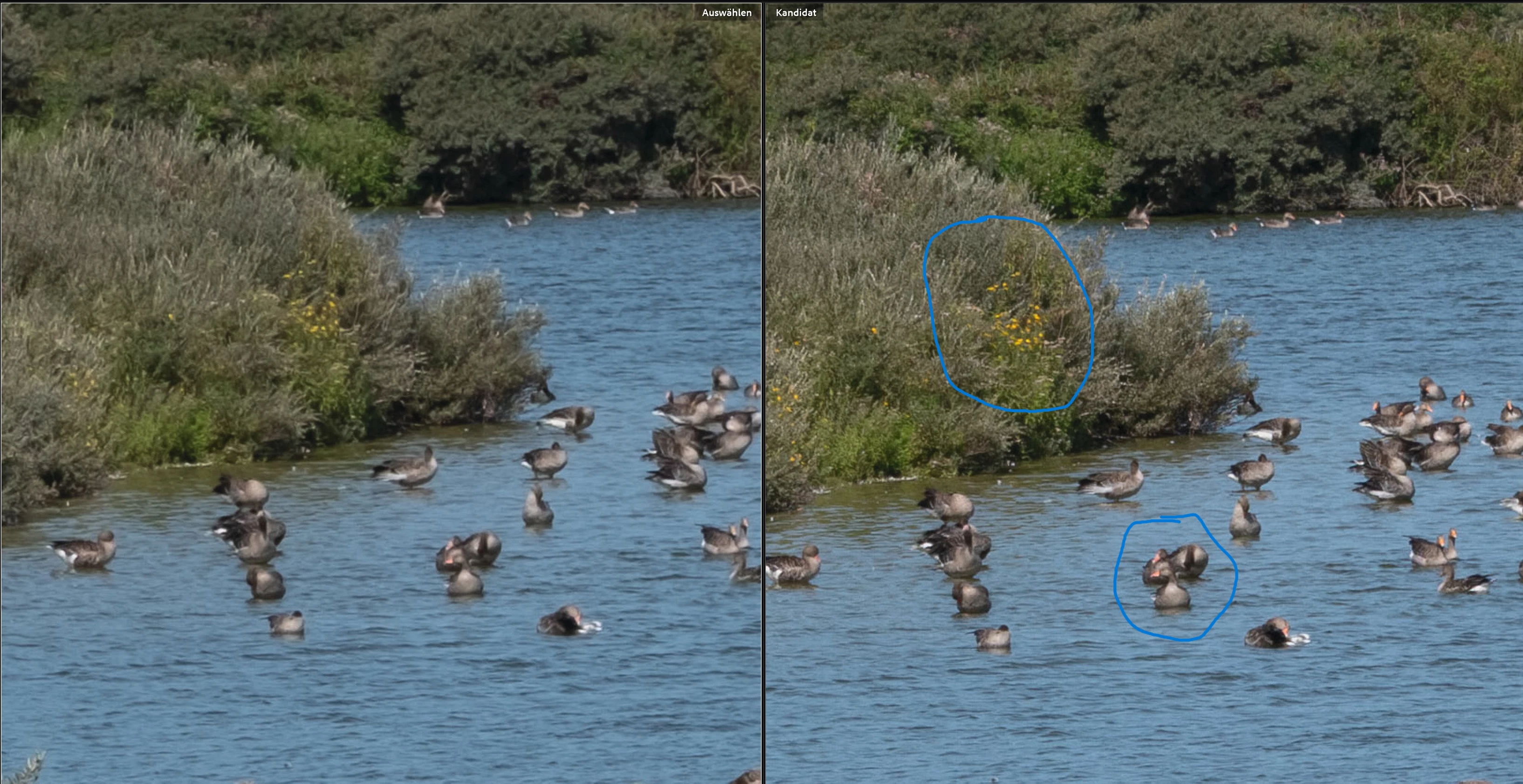

For comparsion, here is the same screenshot, but with raw details OFF on the source image. You can now clearly see that this is what panorama merged used:
Please fix!

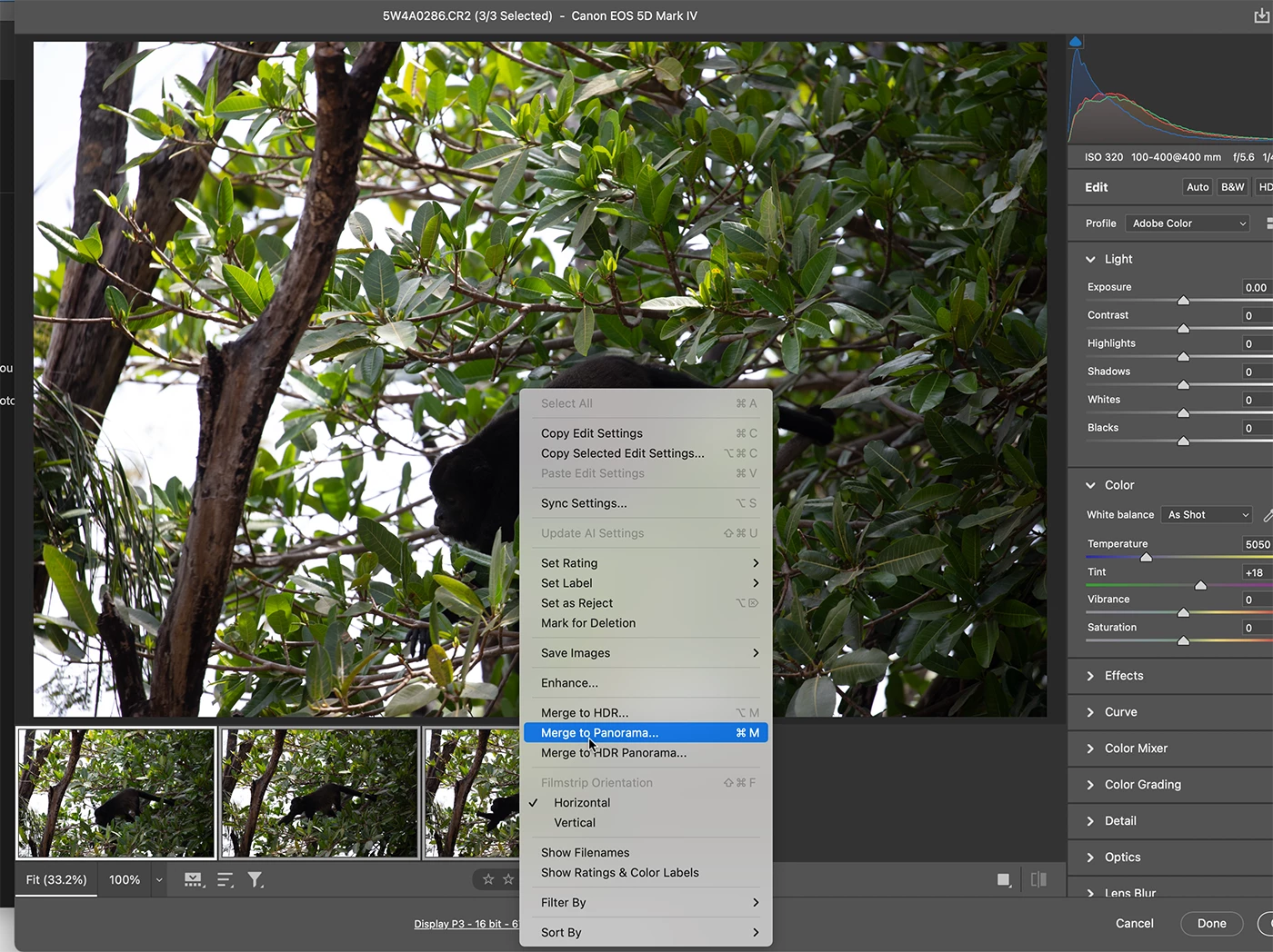

Merge to Panorama is part of Camera Raw, Lightroom Classic, and Lightroom Desktop.  The issue will occur in all three apps.
Here is the dialog in Camera Raw:
