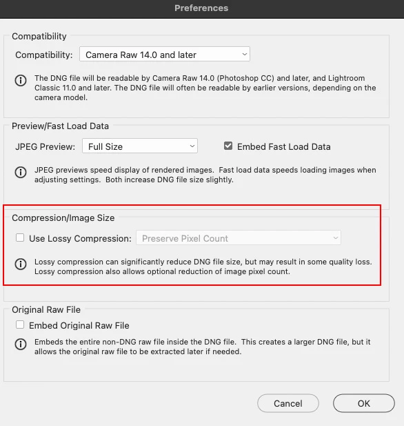

Hmm, not sure where you're seeing an option for lossless compression as that that's the default conversion for DNG. Are you sure that you're not confusing 'Lossy Compression' as shown on attached screenshot of DNG Converter.
Edit: Attempting to use 'Lossy Compression' results in 'not supported', but this option is only used when lower quality demosaiced images are acceptable.
