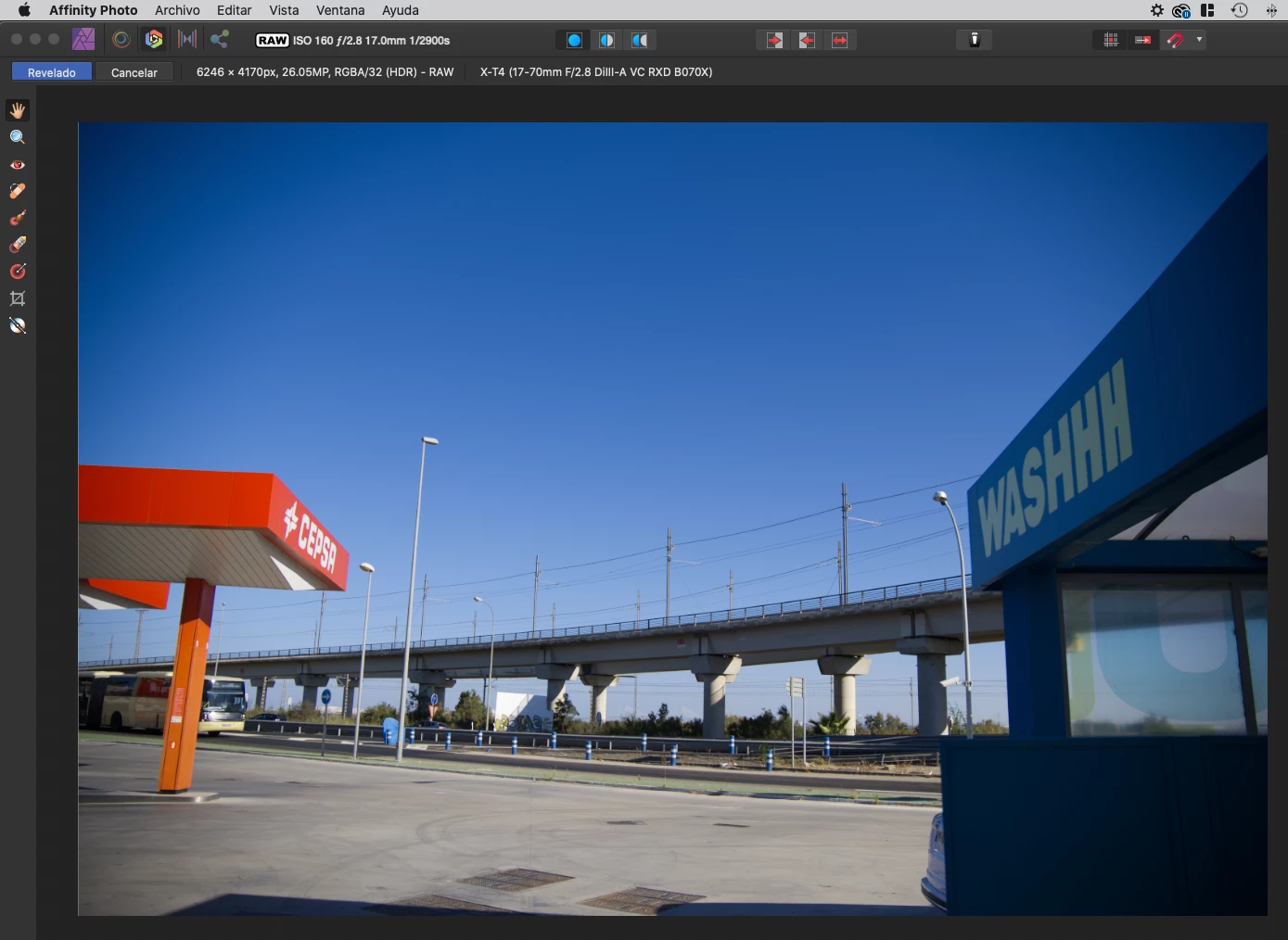

fernandojota
Aug 25, 2022 5:33 PM UTC
Añado el mismo RAW abierto con Affinity Photo, hay viñeteo, pero el efecto desaparece:

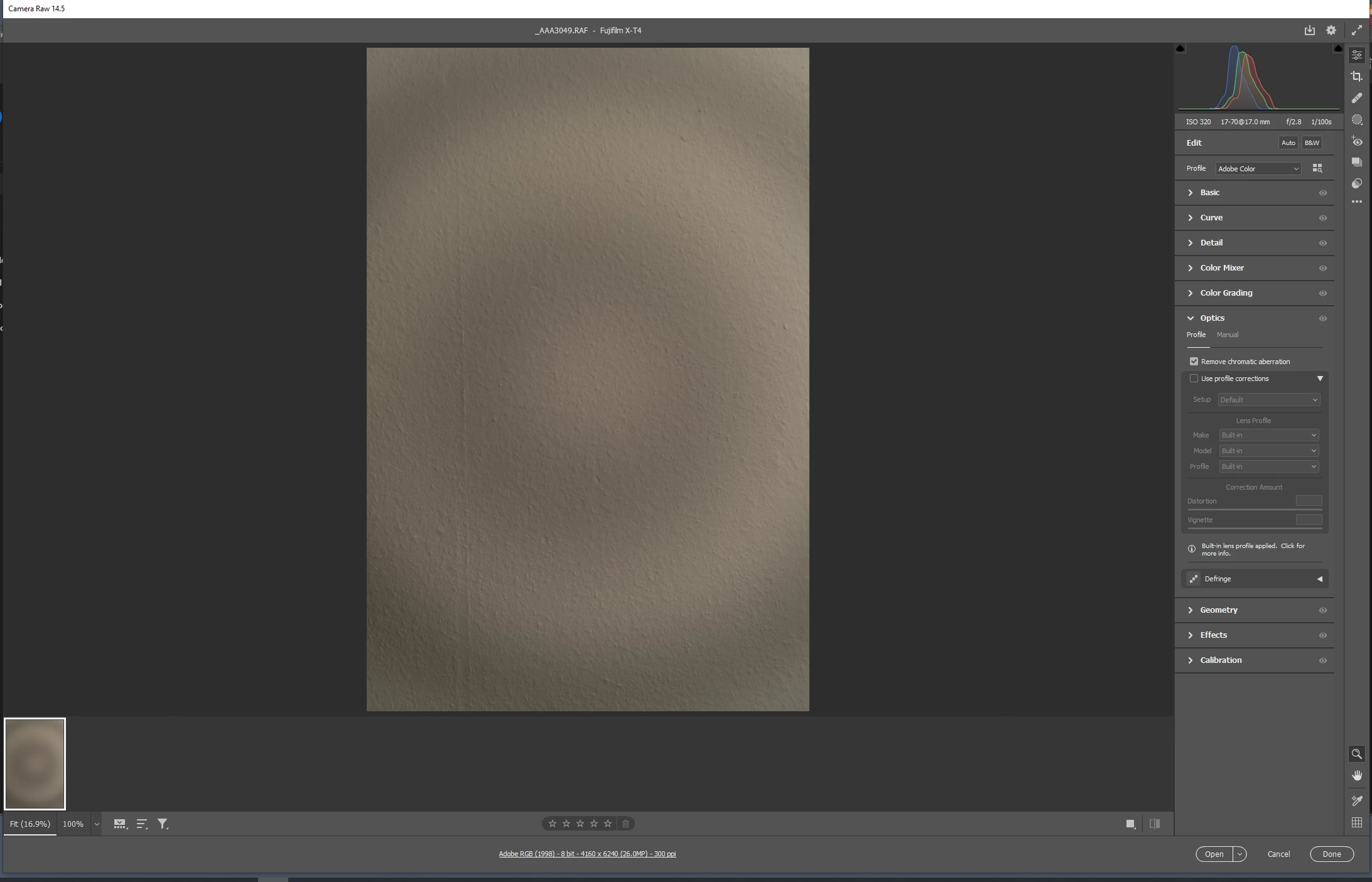

Aug 22, 2022 6:46 PM UTC
In ACR, without Lens profile, then with lens profile, slight change ion vignett, not so much in distortion

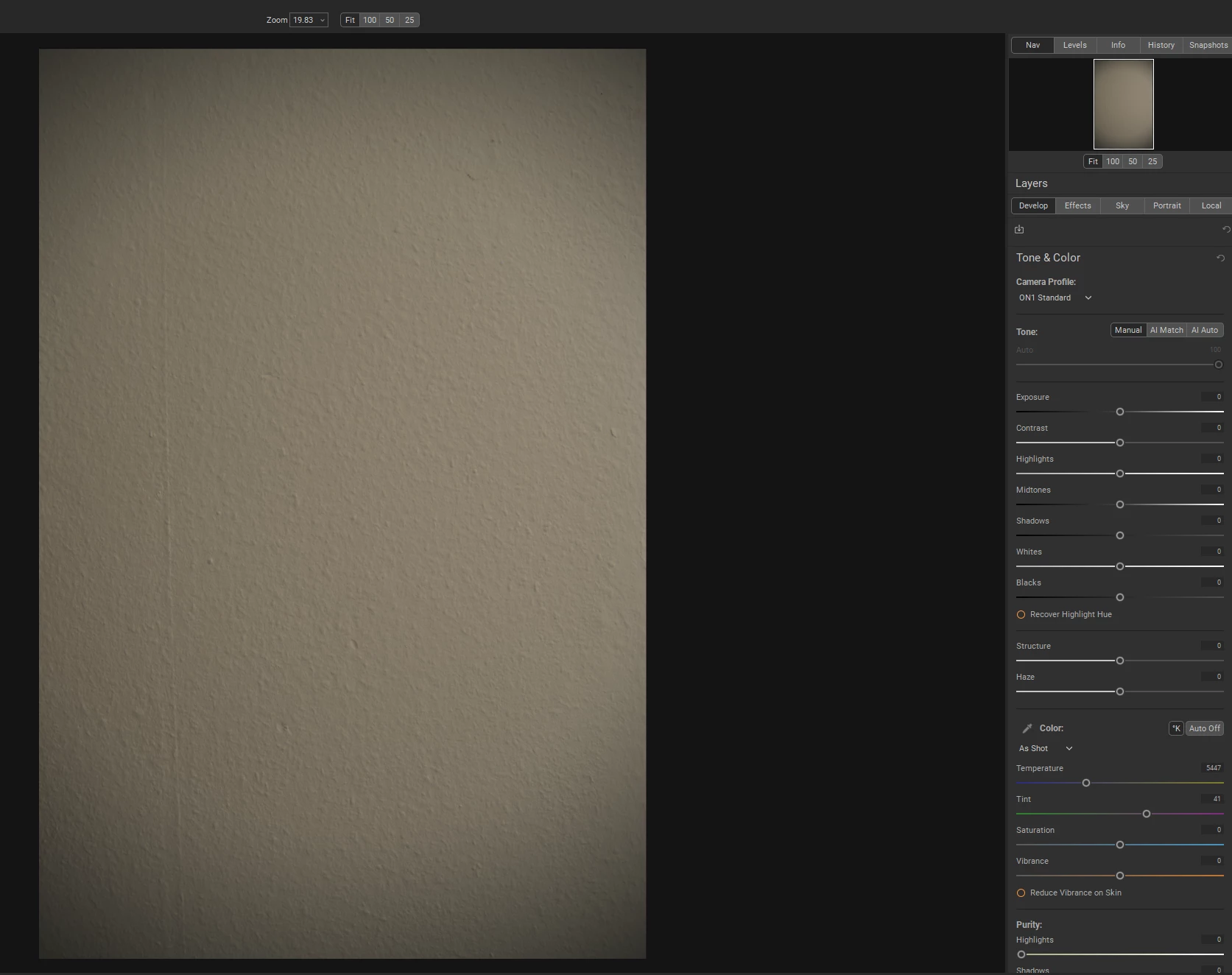

Aug 22, 2022 6:17 PM UTC
Continuing observations
1. Bringing up in ACR, same problem, so perhaps within the RAW conversion by Adobe.
2. Below in ON1 Photo RAW 2022, less vignette. No diffraction pattern.

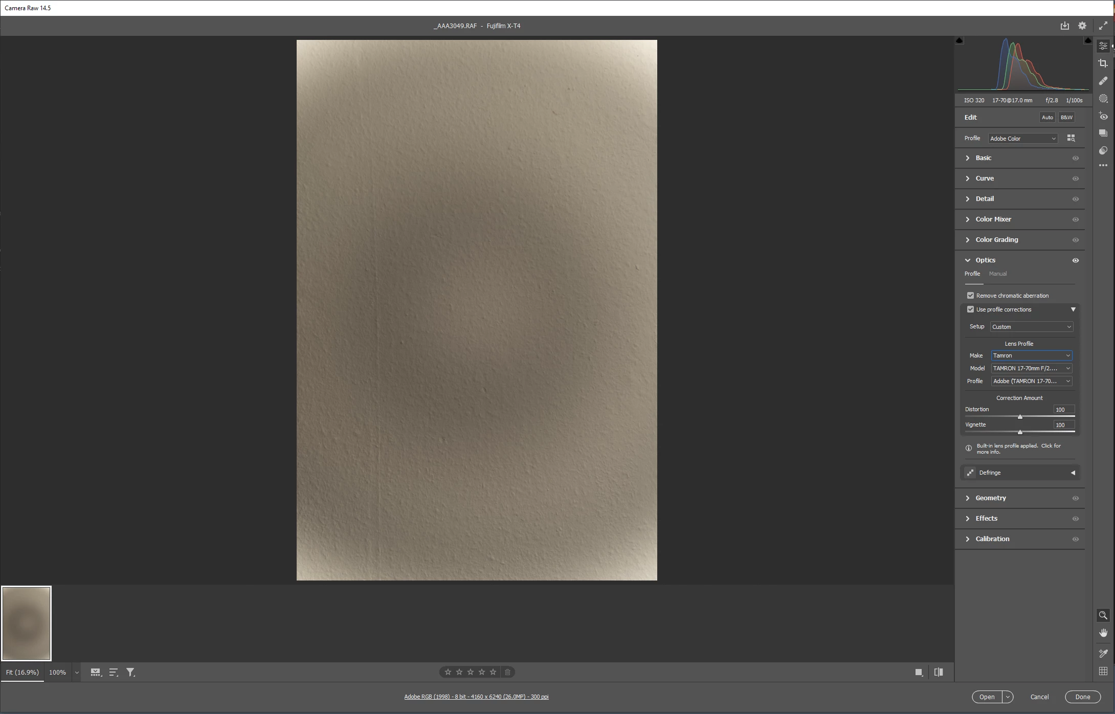

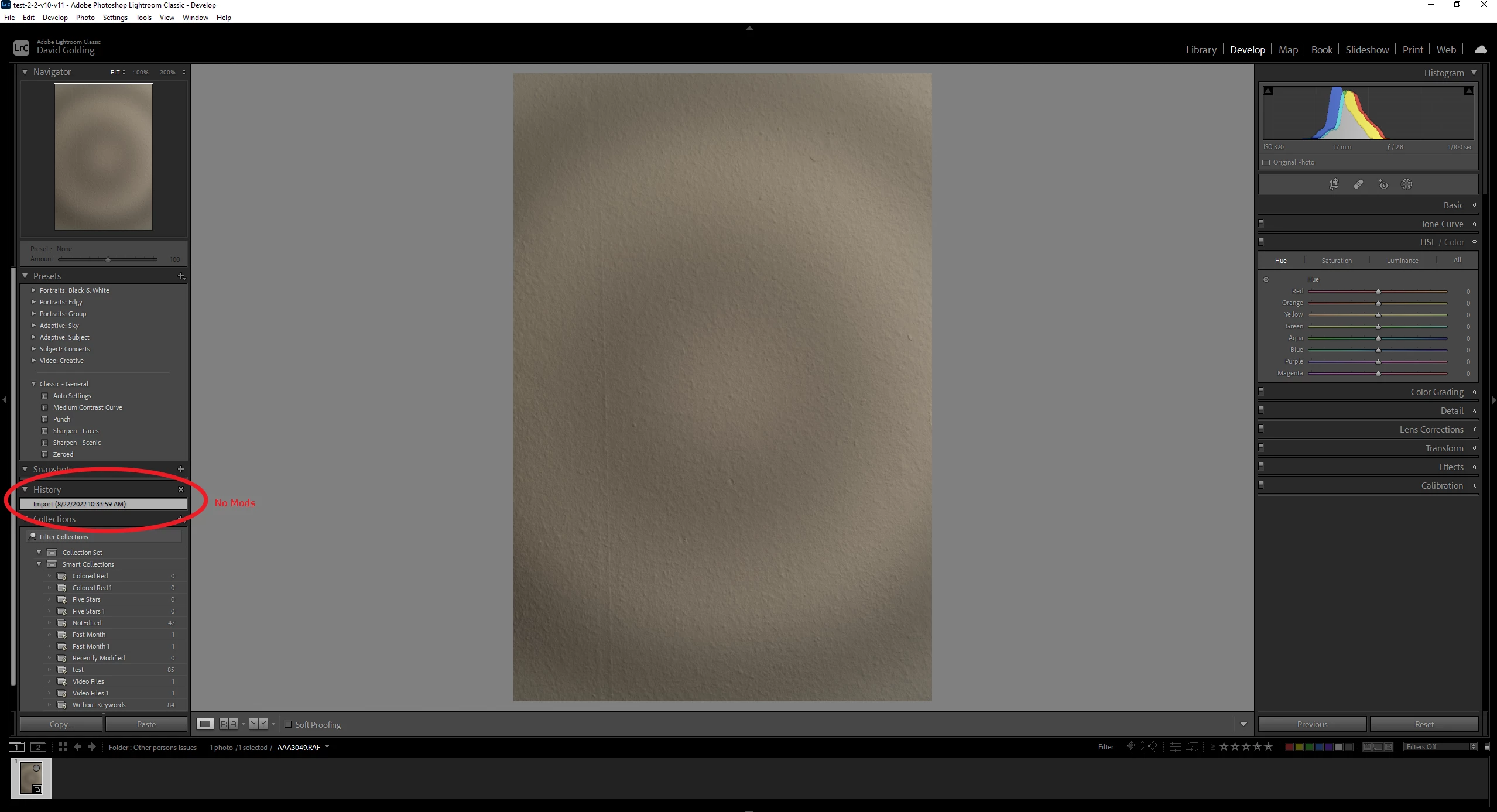

Same issue on my PC with your sample. So not likely to be some setting you may have implemented in LrC.

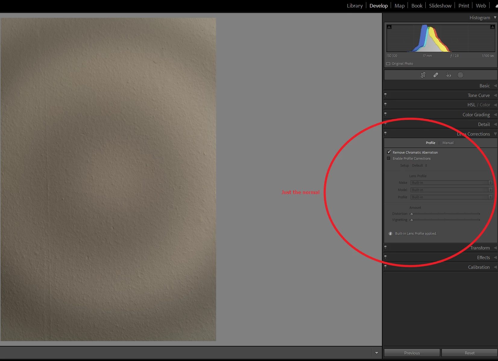

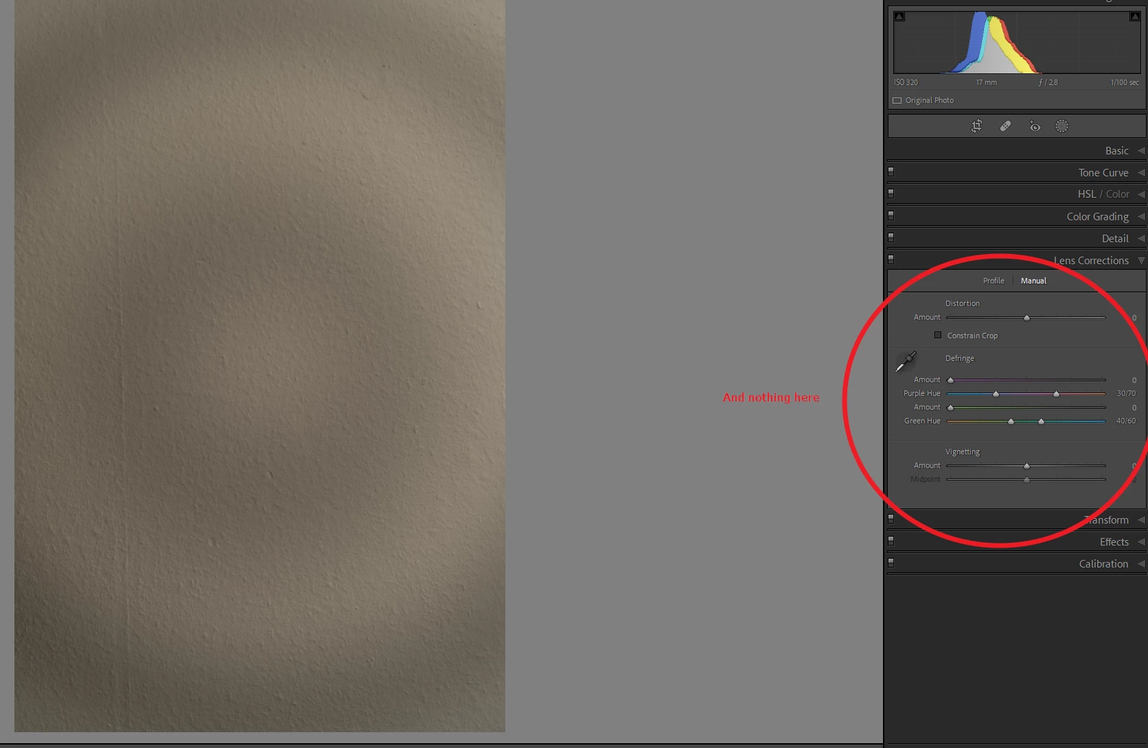

Screenshot of authors sample. LrC v11.5, Develop module, no edits.
Oh, and as for Lens Correcions, nothing odd, Built-in Lens Profile applied as is normal (even non Fuji glass)
And just in case

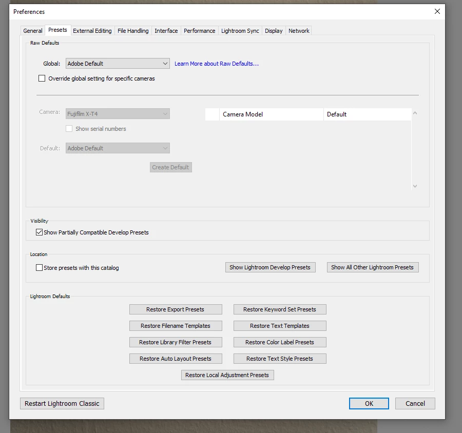

And just to be clear, not a Preferences issue in my rig
