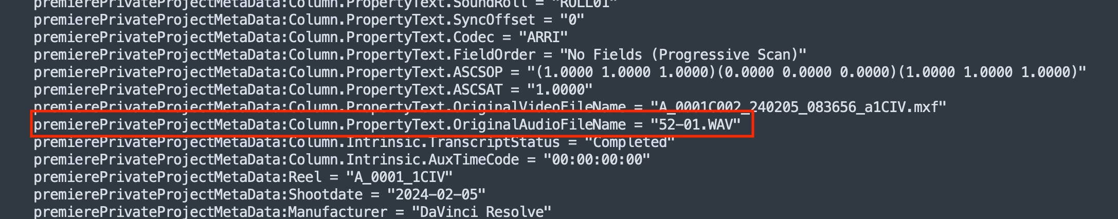

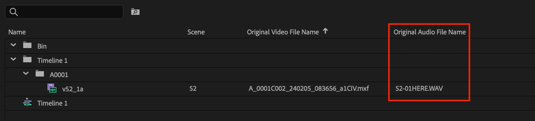

I have an ALE metadata tool I've developed and from all of my testing I'm finding that I can't update the Original Audio File Name field using the setProperty() function on a XMPMetaInstance.
For example:
  var kPProPrivateProjectMetadataURI = "http://ns.adobe.com/premierePrivateProjectMetaData/1.0/";
  var xmp = new XMPMeta(childItem.getProjectMetadata());
  xmp.setProperty(kPProPrivateProjectMetadataURI, "Column.PropertyText.OriginalAudioFileName", "MyWaveFileData.wav")
  var xmpAsString = xmp.serialize();
  childItem.setXMPMetadata(xmpAsString);
This works completely as expected when updating any other default property, such as
Column.PropertyText.OriginalVideoFileName.
Also, when I use dumpObject() I can see the Column.PropertyText.OriginalAudioFileName property, but premiere isn't reading it correctly, and will display incorrect data. See screen grabs and txt file attached.

The video was helpful, thanks!
I propose you send me your panel, and some import-able .ALE files with blobs of data that reliably reproduce the problem you recorded.  🙂
