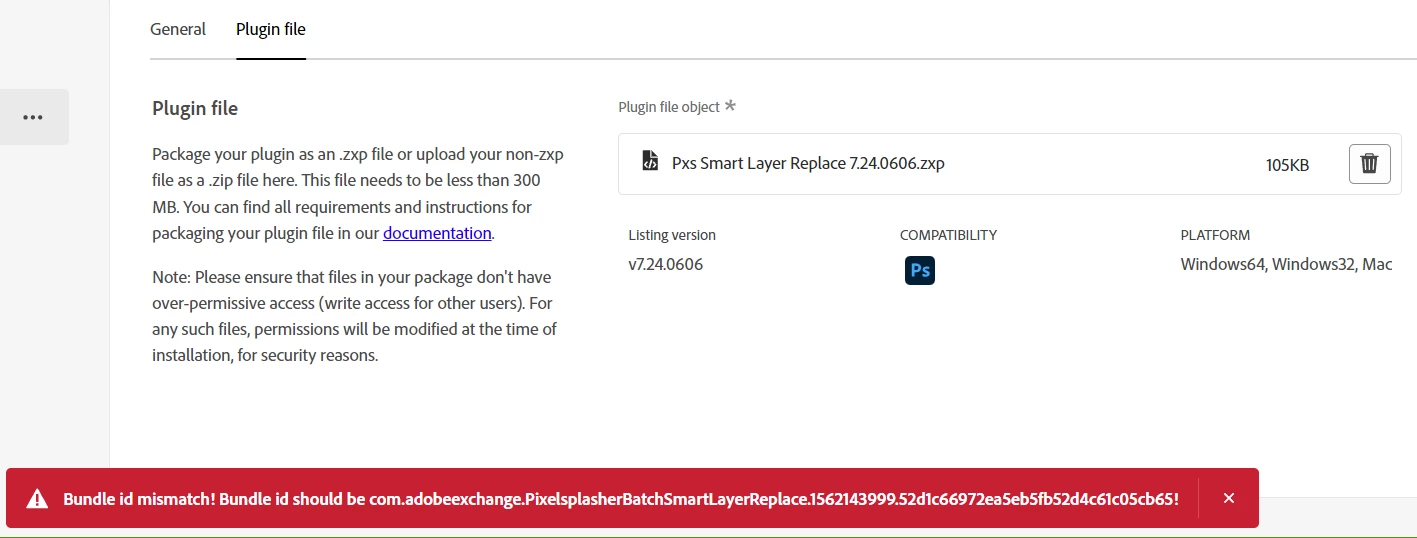

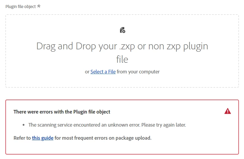

Here is my dilemma:
If my xmi filename, which must be the bundle id, is too long, Adobe Exchange submission rejects my zxp with an unknown error.
If I shorten the mxi filename, Adobe Exchange rejects my zxp because it now does not match with the bundle id.
The solution should be to shorten the bundle id at Adobe Exchange. How can I do that without bothering Adobe staff?

    piXelsplasher
    July 13, 2024
    Reuploading the latest version without editing the manifest already returns the unknown error since the mxi filename must be the same and should match the bundle id.
    After doing these steps:
    • update the downloaded manifest by adding the host app details
    • bump the version to the desired one
    My dilemma is the same. I think the mxi filename length restriction was placed just recently. Any chance to have it repealed until we have the ability to shorten the bundle ID?
