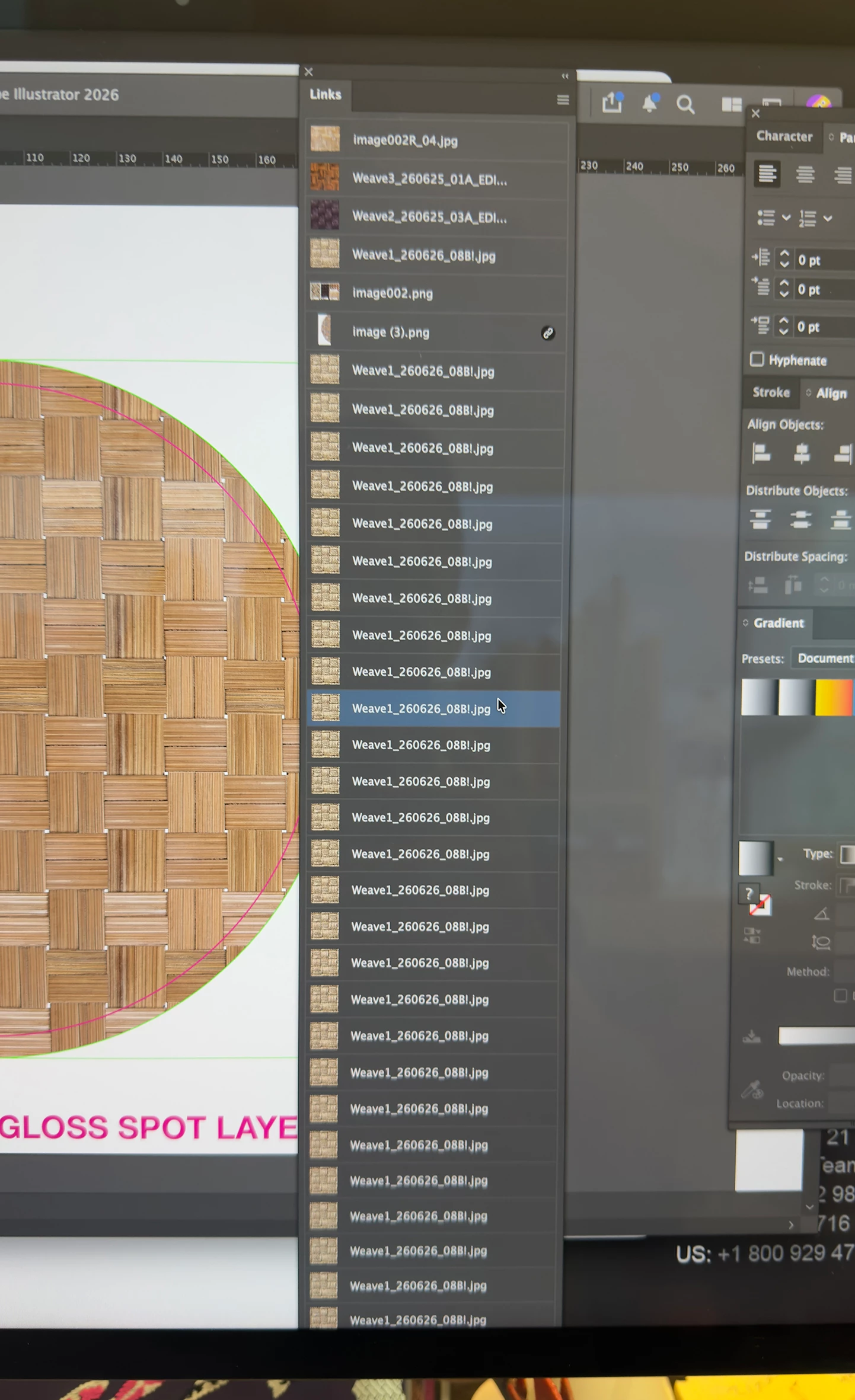

Jul 14, 2026 3:37 AM UTC
Suddenly my current painpoint using Illustrator 2026. The link palette is too tall and cannot reach the bottom to adjust. The worst part - the palette blinks when I hoover the cursor to fix it. It was not like this before. It opens like this tall on any of my files. How to fix it. Anyone encounter this before?
Anubhav M
Jul 14, 2026 11:09 AM UTC
Hi @JINO,
Sorry to hear you're hitting a similar issue with Illustrator. Please try the following:
  1. Dock the panel with another one, as Kerobo suggested, and see if that resolves it.
  2. If the issue persists, switch to a different workspace and share what you observe.
If any of this resolves the issue, kindly mark the helpful reply as the correct answer so other users facing similar trouble can find the fix.
Anubhav
