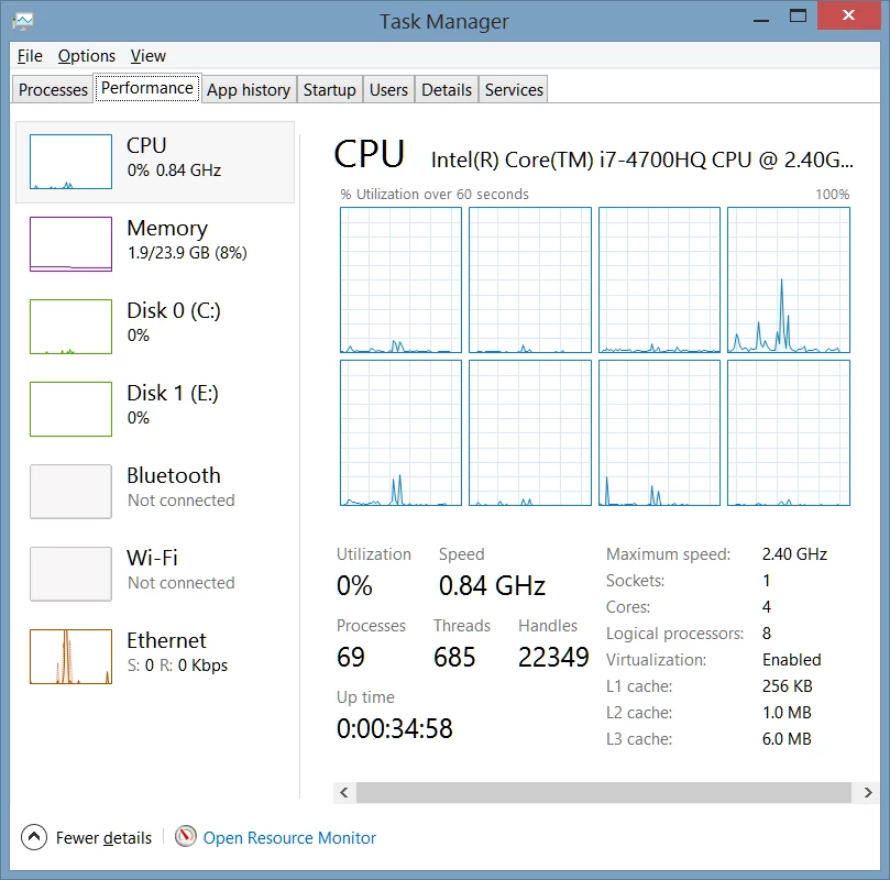

Look at Task Manager on the Performance Tab and tell us how many processes are running.  Here is my very well tuned laptop.

As I said, my windows relatively clean as It's only two months old. I have some more processes but they are light (Adobe, light-set antivirus, and some from my peripherals)..nothing big. And I have very good performance working with another apps, so it's something related to Premier.
