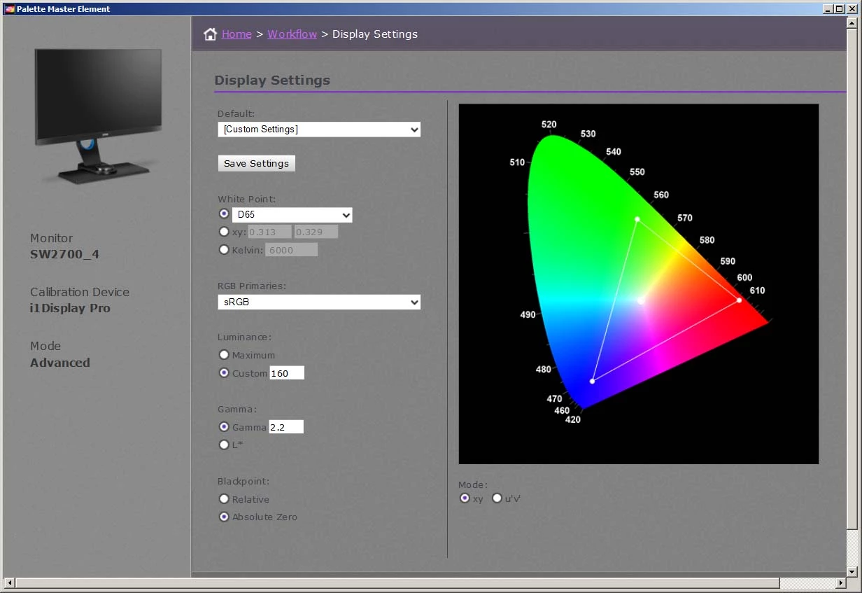

    Try setting the Color Mode to sRGB.  This will be the factory sRGB calibration.  My guess is this will look right.  If it doesn't there's little point in attempting a calibration to sRGB!
    When you say you run an sRGB calibration, are you performing a hardware calibration with the Palette Master Element Software using a device like the i1 Display Pro?  If so, you will need to select Advanced mode and select 'sRGB' in the RGB Primaries box on the Display Settings page.  The page should look something like this:-
