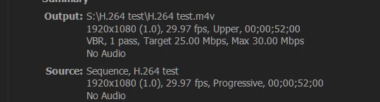

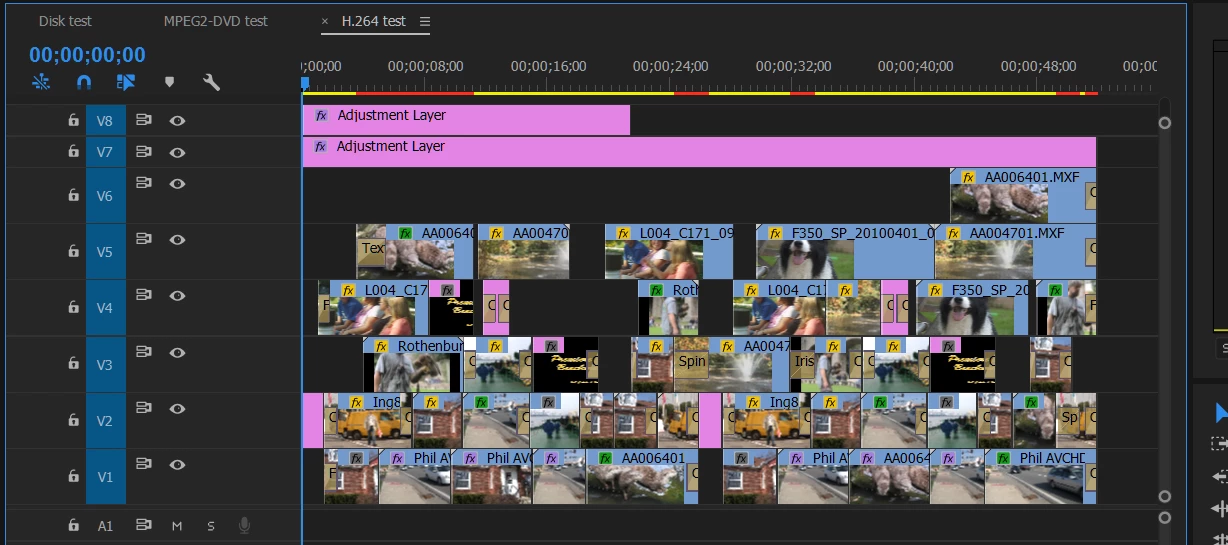

I do not have any H.264 media clips to test but when I export my 8-layer multiple media types 52 second timeline in my PPBM benchmark to h.264
from this timeline

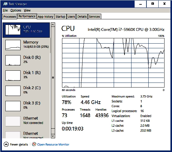

My 8-core i7-5960X @ 4.5 GHz CPU utilization looks like this:
The export time is 50 seconds.
