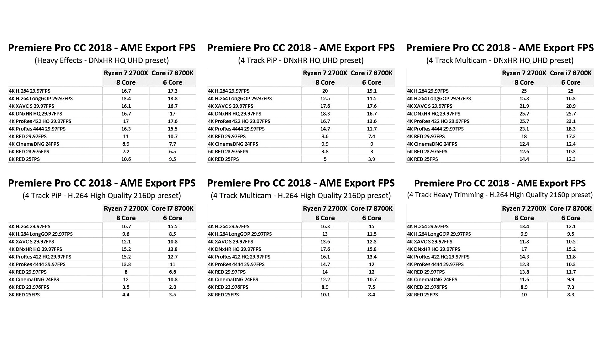

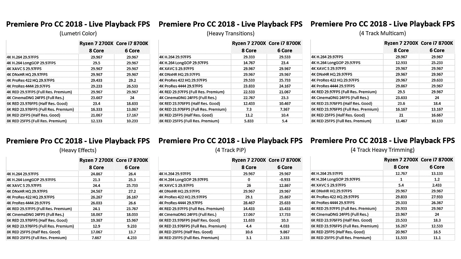

As for Adobe Premiere Pro performance these tests speak for themselves:
https://www.pugetsystems.com/labs/articles/Premiere-Pro-CC-2018-Core-i7-9700K-i9-9900K-Performance-1254/#AMEExport-RawBenchmarkResults
I lean toward Ryzen 2700X. It has great price. Spared money can be used to buy more and/or faster memory which is always good or good graphic card which will boost the performance.

I skimmed the graphics a bit to get the clearest ideas, and in the end they are the same, the Ryzen behaves slightly better on some things and Intel on others.
My choice at this point will fall on the price and availability, in this sense the Ryzen has a lower price and with the same amount that I would spend on motherboard, ram and Intel processor, I take a Ryzen + ram (faster), a m.2 EVO and the motherboard.
