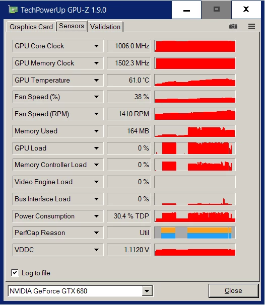

Take a look at my PPBM web pages.  Adding a second card does more work if needed but unless your GPU-Z shows that your card is working at its full load it would be a waste of money.  The plot below shows this old card
working at its max with a timeline that was specifically design to stress the GPU.  Adding a second card does more work if it is necessary as in this case.
Actually I have used two GTX 1060 6GB SC cards at less money than the more expensive single card solution.
