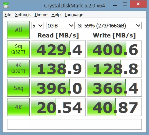

How would you like this sequential read,write rate for only $99 for 256 GB (500 GB , 1 TB and 2TB models available):
This is the Samsung T3 portable USB 3.1 SSD, I use these connected to my PC laptop and put all my Project Files and Media on these an can move almost instantly from my laptop to my desktop and back.  No real performance difference with Thunderbolt and typically at less cost. I now have three of these devices and while your iMac does not have USB 3.1 if you did have you could even expect slightly better.
