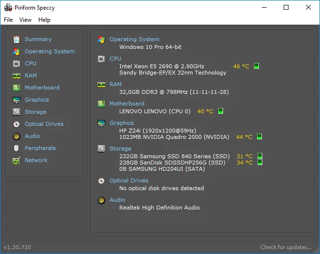

My friends computer.
Intel Xeon E5 2690 (8 Cores)
32GB Ram PC3 12800
SSD 256GB
Quadro 2000

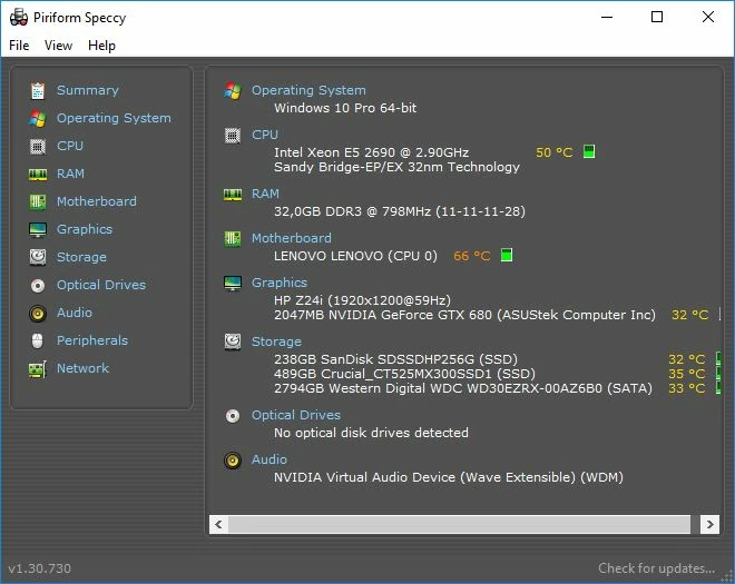

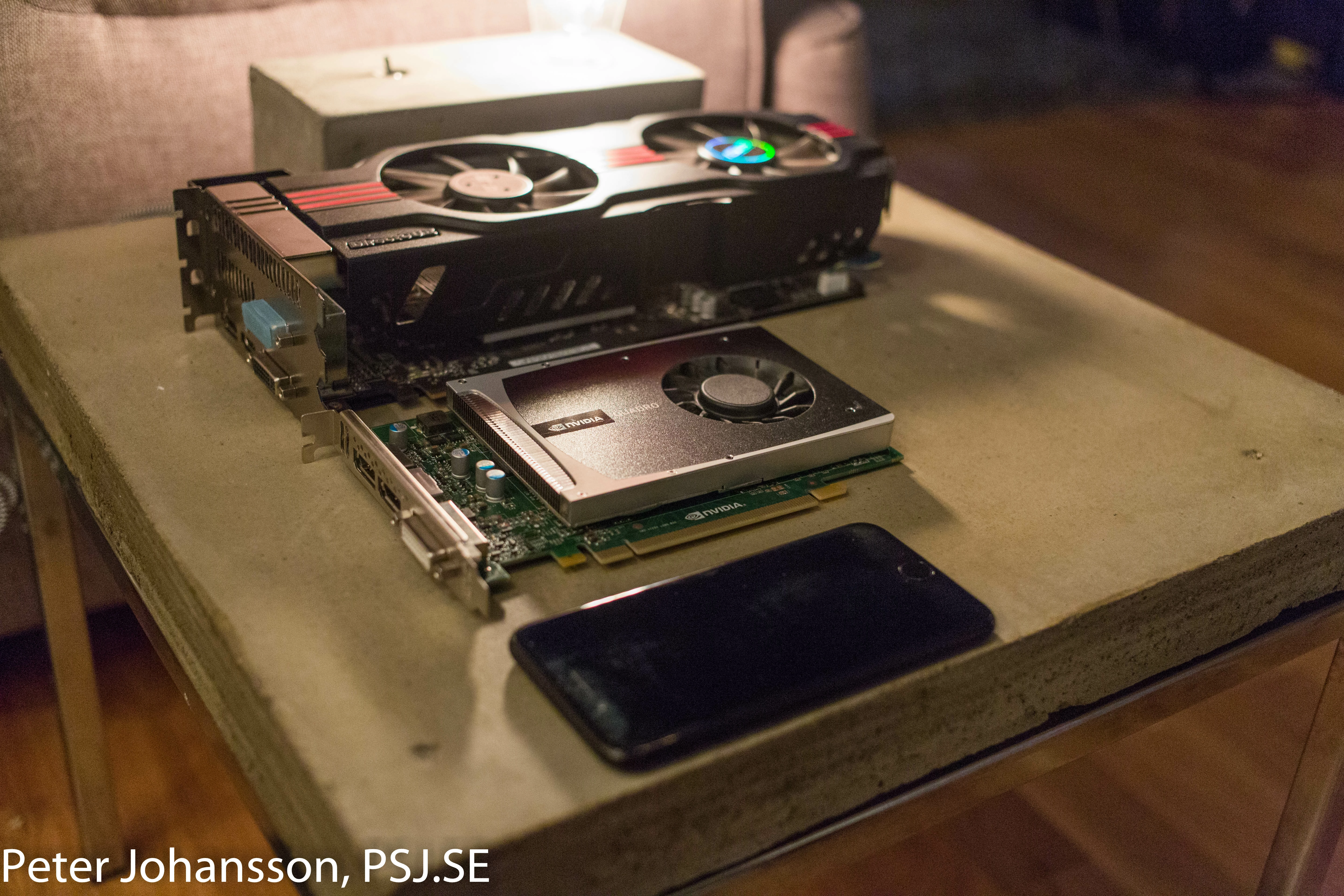

    Okay, now my GTX 680 is in my computer, bad or not it's there
    here is a pic of the size-diferense. i know size doesn't matter but its a impresive peas of card.
    So i installd al the defalt driver and PP worked perfect.

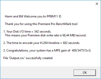

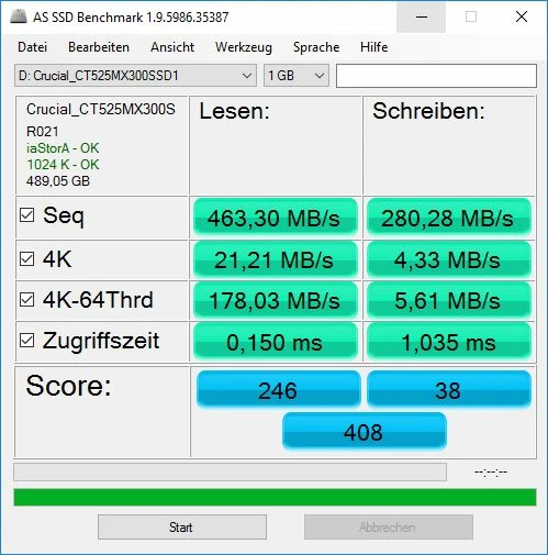

    as you can se is the SSD is not working fast. Dont know why. i made a test a few days aga and i got ~500/500mbs
    today i got this..
    Mar 28, 2017 11:41 AM UTC
    Unfortunately, this joy may be very short-lived. Who knows what the next major release of Premiere Pro CC may bring (in terms of MPE GPU acceleration support)? That is exactly why I did not, and still don't, recommend getting any older GPU that is on the brink of becoming EOSL'd.

    I have also replaced the 250gb samsung with a new 525 gb Crucial that reads and writes ~500MB/s.
    Hope the results will be better.

    3. I have not seen that bad write performance on any of my Samsung 840 Pro SSD's is that a 840 EVO?
    4. They will be better!
    5. I have never tried that but doubt that will help and actually think it will increase your CPU intensive score
    Mar 24, 2017 4:44 PM UTC
    It's not a pro just 840, but far from the samsung spec.

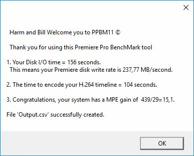

    I made a new test.
    This time with a separate SSD (Samsung 840).
    The strangest thing is the H.264 time!
    Last test is with no CUDA.

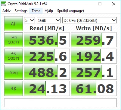

    Mar 23, 2017 11:51 PM UTC
    Notice your results on # 1 above where your Disk I/O export time of 250 MB/s matches the ~250 MB/sec sequential write rate of the CrystalDiskMark scores.  This is not as good as a good SATA III SSD Should do but much better than any hard disk drive.
    Your H.264 score is reasonable without CUDA assistance, this laptop with GPU acceleration turned off scores 1385 seconds and my 8-core i7-5960X at 4.5 GHz is 411 seconds

    Here is my results.
    Mar 21, 2017 7:05 AM UTC
    It's very strange results compared with Dazzin. The computers are still quite similar in performance but still it's very big difference in the results.
